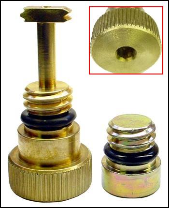

The HPOP has a water drain, and should be checked/drained at every service IMO, or even more if your not certain of the fuel suppliers if traveling ect, or, if the tank is at lower levels consistently. Wet/cold/humid climates or conditions when buying fuel would have me giving the drain a quick check at regular intervals as well. It's better to check and/or take fuel samples to better insure any water intrusion from anything from contaminated fuel cans (seen that a bunch), transfer tanks w/without filters, to fuel stations that may be the culprit if they don't move alot of fuel volumes. Also Bio diesel if not the correct blend.
The LCF trucks use a knurled fuel plug that makes a 'quick' check a breeze, more so if you should get a WIF light and need to drain it ASAP.. It's a direct replacement for the OEM 6.0 plug and can be finger tightened. It also has a 'T' end that keeps it from dropping out and helps to wick the fuel away from the frame and HPOP when draining..
Here's a pic of the upgrade plug.
