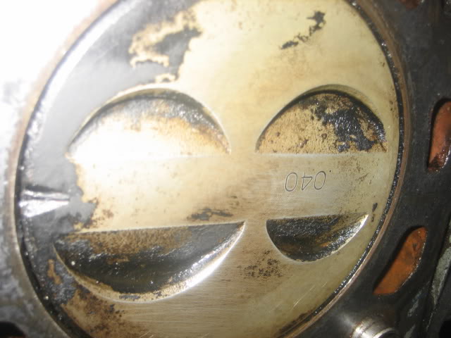

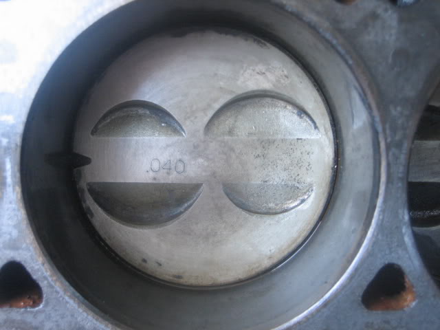

ok so i have a 302 .40 over and it has these pistons. anyone tell what they may be from this pic.
Attachment 2794
Attachment 2795
thnx
oldskooloutlaw 10-10-2009 01:59 PM
They are aftermarket pistons with valve reliefs for large intake valves probably with a high lift cam.IMHO

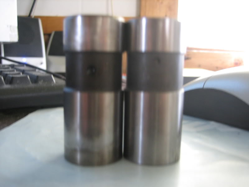

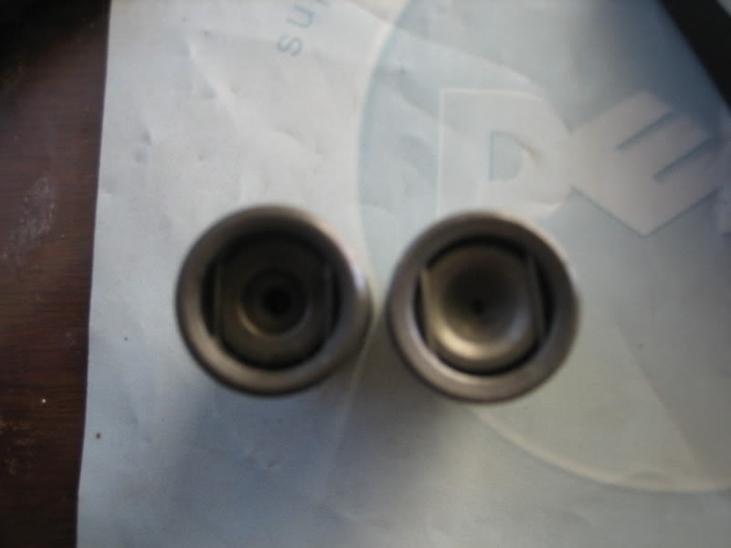

2 Attachment(s)
thnx. also i have these lifters. any idea what kind they may be. and is there a way to measure lift by how much of the lifter is above the lifter bore. i mean is there a standard hight so i can compare.
the one on the right is OEM the left is aftermarket. it says L900
Attachment 2790
Attachment 2791
oldskooloutlaw 10-13-2009 10:52 AM
RE: camshaft lift
No those are regular flat tappet hydraulic lifters,in order to obtain cam lift/duration you will need to id the cam model and make,then you can get the spec sheet,it more than likely be a ford cam and have a letter stamped on the front where the cam gear mounts.
