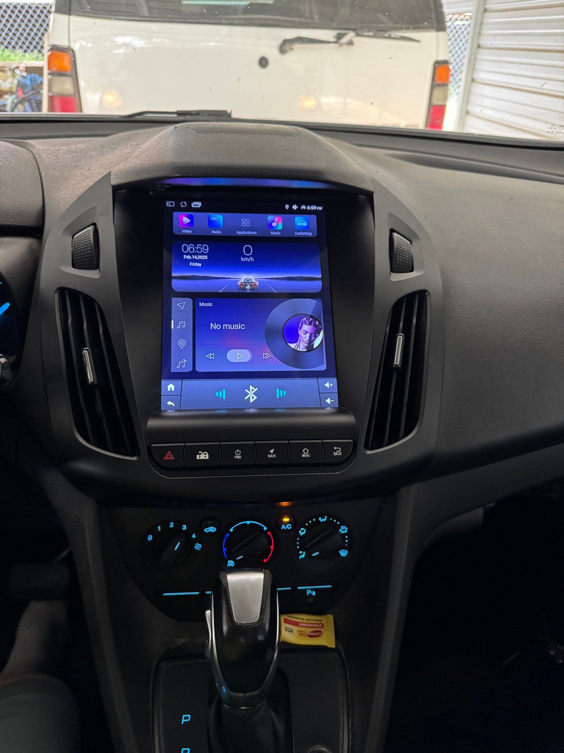

After installing a 9.7” Android 13 CarPlay Radio GPS SWC 32GB in my 2014 Ford Transit Connect, the airbag indicator light has come on. There was a small circuit board labeled airbag on/off with a 6 pin male plug included in the wiring kit but I could not find where it was to be installed. Anyone have any suggestions? Also the only button on the lower horizontal selector that worked was the emergency flashers. The door lock, power button, Navi, menu, and back button does nothing. I only have wiring from the Canbus decoder going from the decider into the radio and nothing connected on the other side of the decoder. Will check into that.

Well, the battery disconnect did not work. Airbag light did go off for a second but came back in steady. The GPS antennae that came with the HU is working and I can access it from the apps option. Google maps works once connected to my hotspot. Just can’t access maps from the Navi button on the lower buttons. My scanner is low level so I will purchase on today that can scan and reset SRS. The only other roadblock on install was there was no accessory power or run power from factory harness that I found which was odd. I just picked up power from elsewhere and cut and spliced into ACC/RUN wire going into radio plug.

Good morning Heiiko. I went back into my email of the HU purchase and looked at the wiring harnesses provided and lo and behold, I noticed the little airbag card connected to one on the smaller connectors. I plugged it up and connected it to a cap harness that was originally plugged into the main function control of the OEM radio, that had passenger airbag indicator, that I had missed, and that solved that problem. Airbag light off when running. I will try your suggestion on programming the steering wheel functions although I don’t have steering wheel functions and see if that fixes the lower functions issue. Thanks for your suggestions and help.
