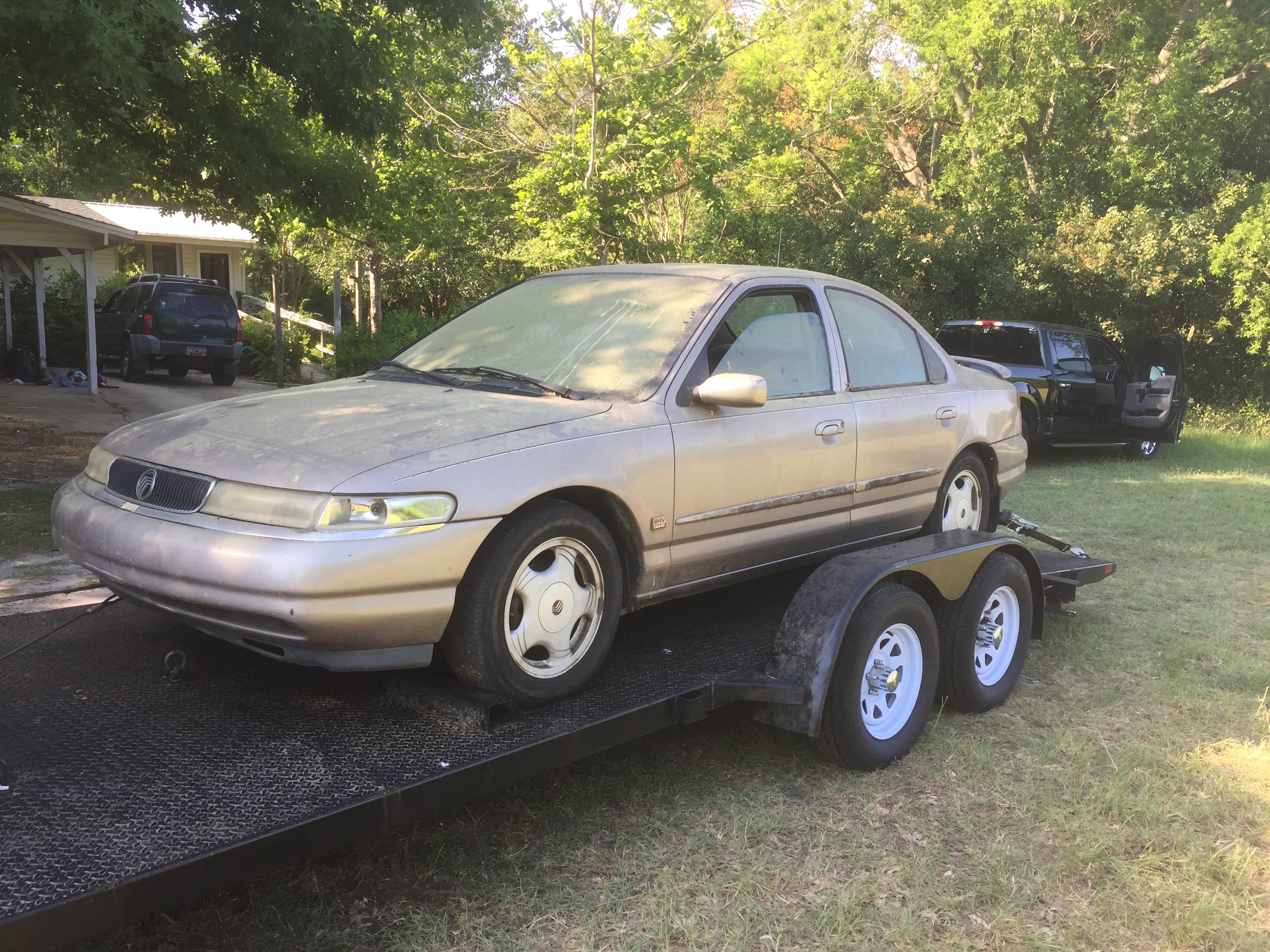

Trying to resurrect this 1995 Mercury Mystique V6 5speed. The clutch master cylinder is bad. How does the hydraulic line disconnect from the clutch master cylinder? There is so little room to work in there and I cannot figure it out. Thanks in advance.

There's a horseshoe clip locking the line in place..
