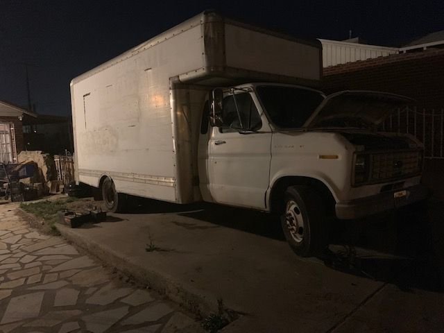

Hi Guys! I got this van a while ago for my business to help move heavy items around. I think it's an ex-u-haul van.
It's got that international 7.3L diesel in it. I am ok with gas mechanics, but I don't know a whole lot about diesels.
Long story short. I used it a lot, and it ran perfect. Then I parked it for eight months. I went to start it today, and all it does it turn over, endlessly, it doesnt sound like it even wants to start. Just a consistent turn over.
I love my baby, but I don't even know where to begin to try and fix her. To make matters worse, I'm a bit short on funds to hire someone to come fix it for me.
