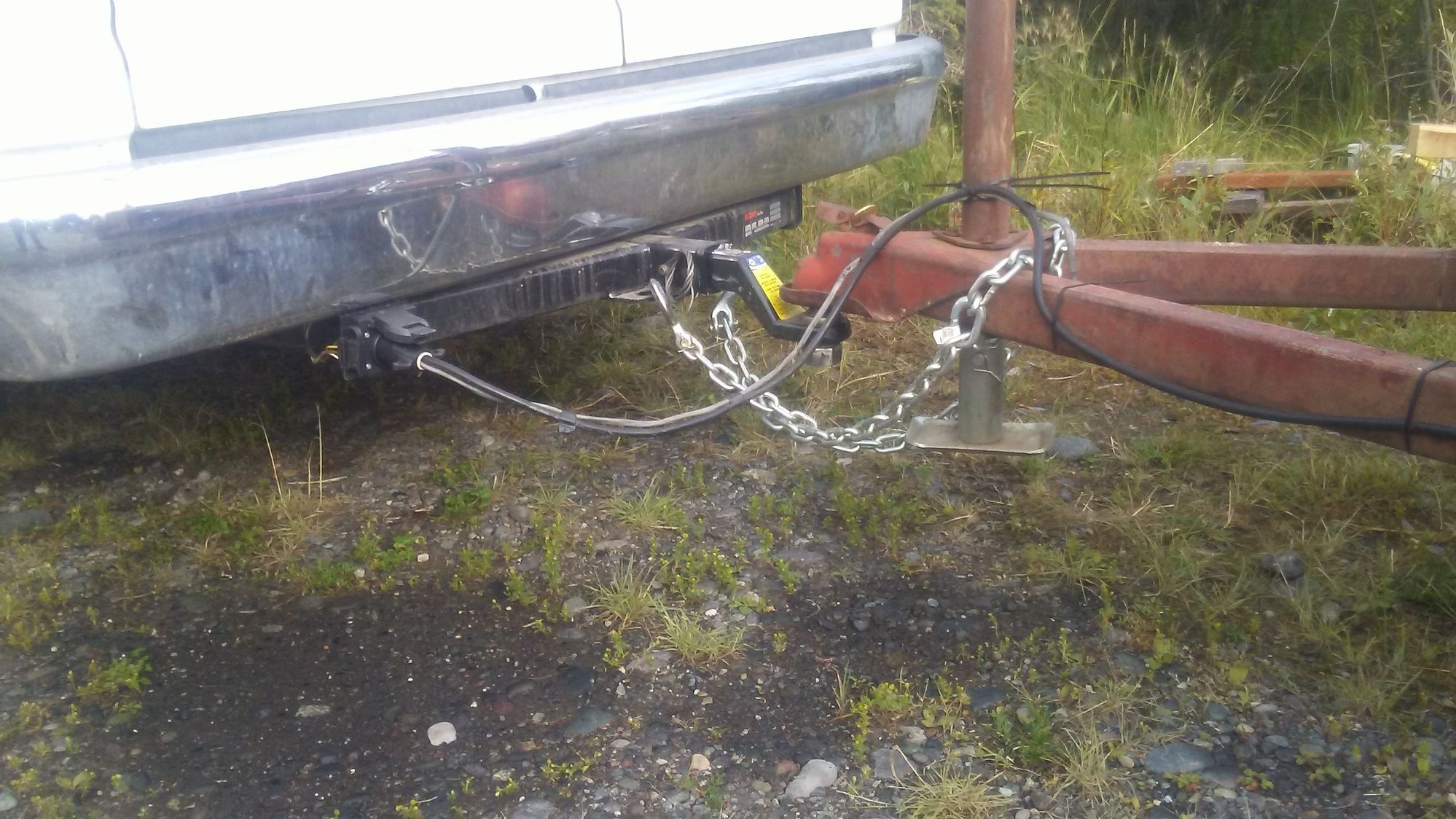

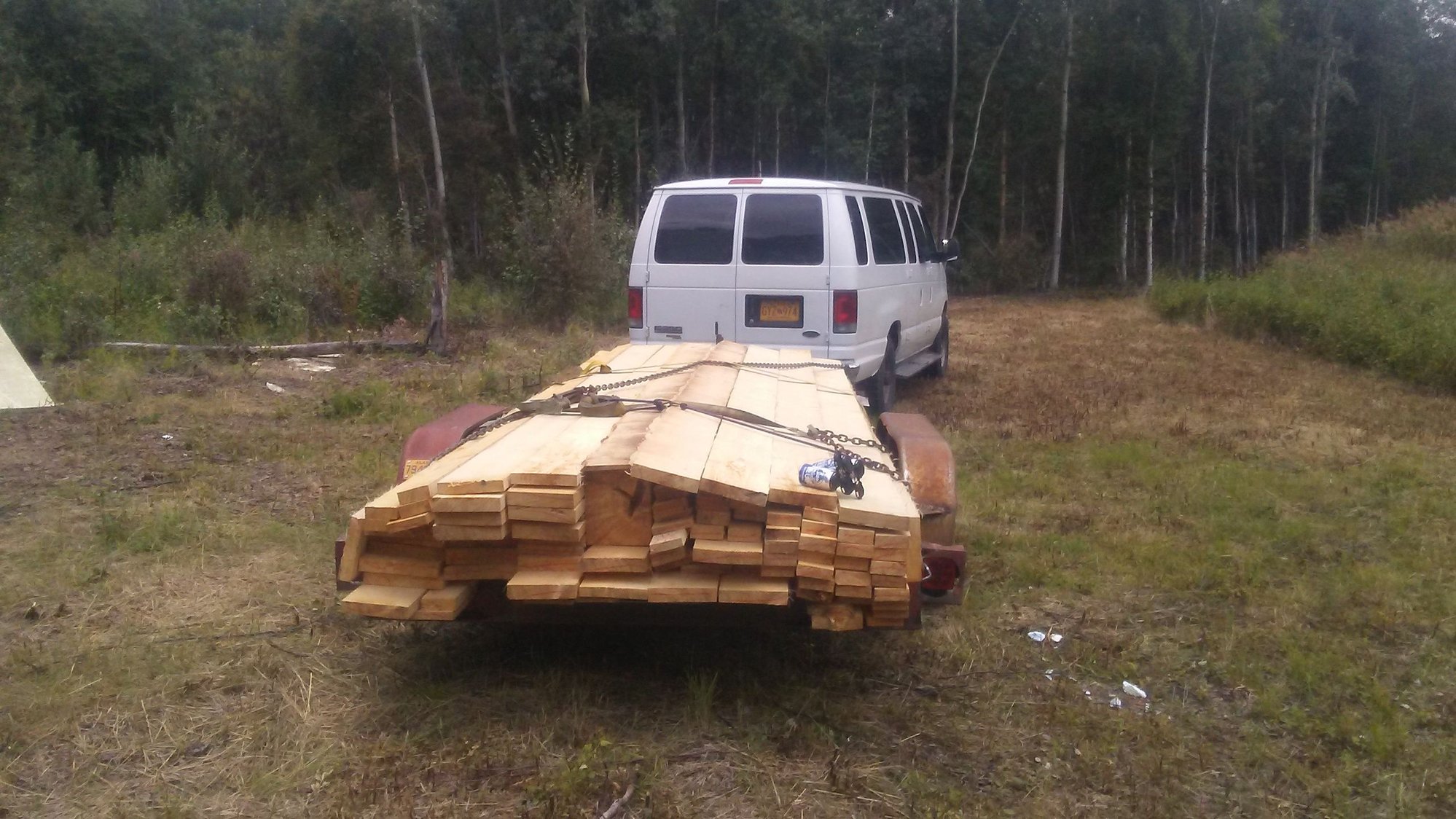

So I had bought the 7 blade round with 4 flat. Connector in Anchorage and a friend brought it out. They also did the work of hooking up the system for me.

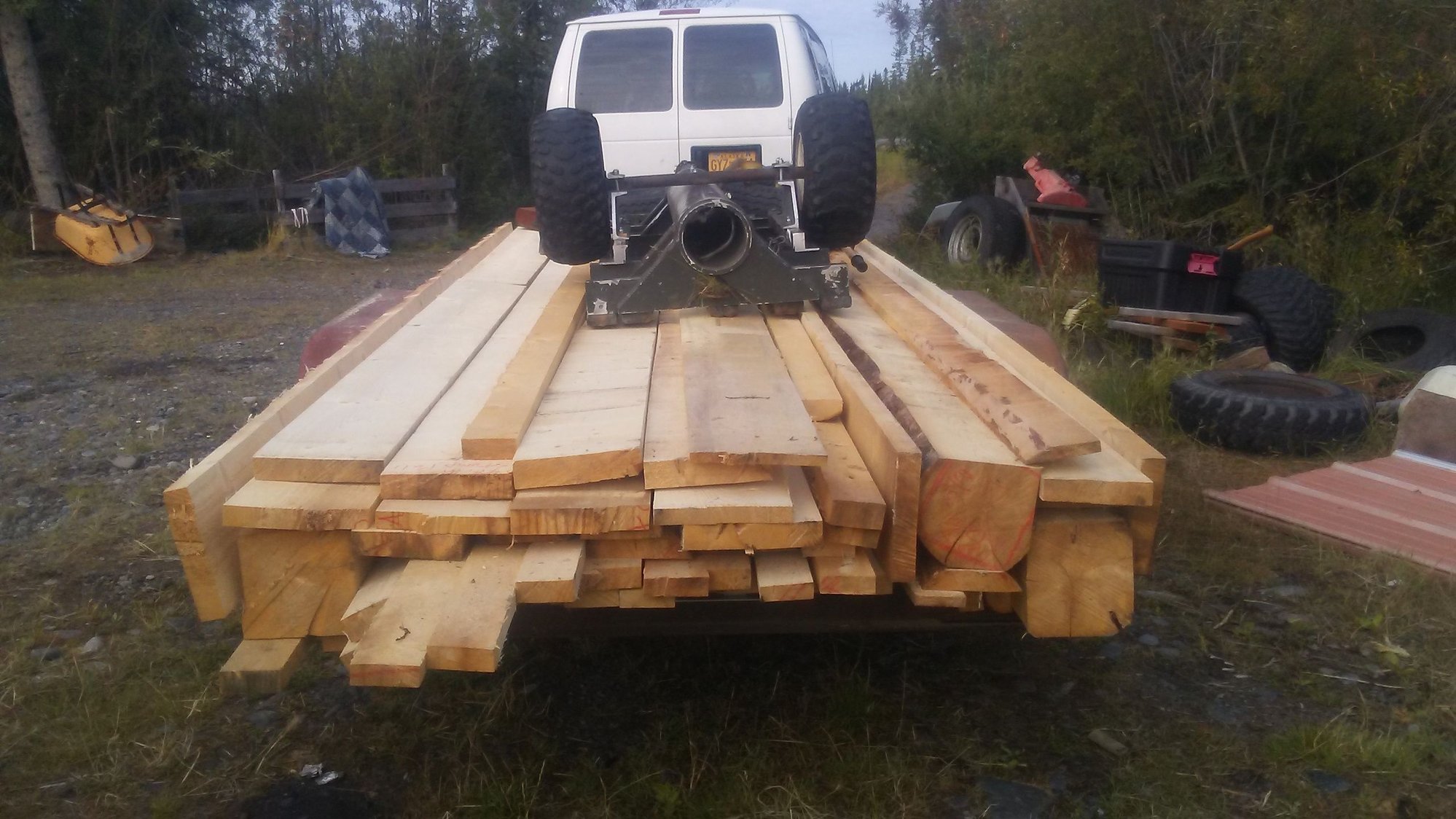

So this is how it looks now. I have hauled 2 loads of lumber so far with it .
Mostly all 16' plus trim rough cut lumber. Running around 6,000 lbs per load. Plus the weight of the tandem axle trailer. I haven't had it on the scales yet but it's probably around 8,000 lbs.
Thank you all for the advice. It really helped. The brake controller that I got from NAPA works good and the Curt 7 blade does also. I did need to supply about 40 ' of 12 ga. wire as we had to go to the battery for power for the trailer brakes.

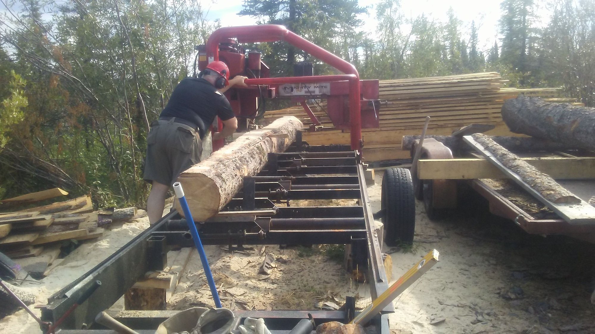

I'm building my house. I logged and milled the logs this summer. And I need to get building very soon. I've been doing site prep. Winter is coming so I need to get framing floors and standing up walls.
Logging with a 4 wheeler is alot of work
Milling with my Mighty Mite bandsaw mill
