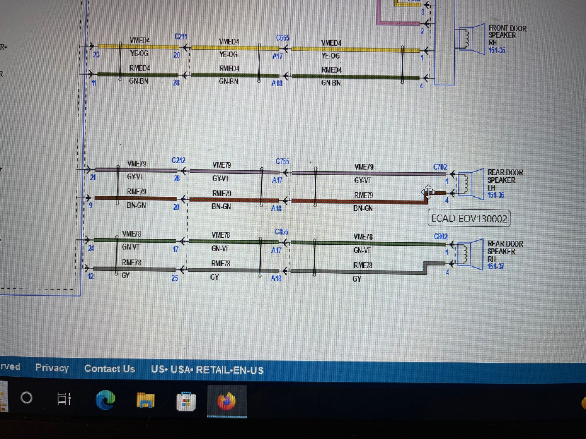

Need to find out which wires are positive & negative on the rear doors speakers of my 2022 edge. Going to be Wiring line out converter. Anyone help a brother out.

Should help..
