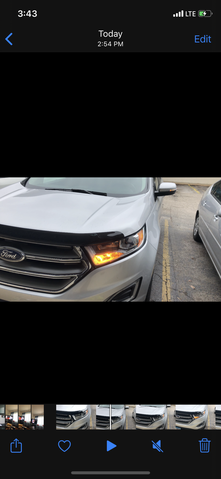

Hi i just install led turn signal from lasfit for my 2017 ford edge titanium. So interesting thing is when my car light is off turn signal work perfectly fine but when i turn lights on it act differently like turn signal go dimmer and it will get hyper flash. So again when my car light are off it work fine but when its on it just doesn’t work as it should be. Is there way i can stop this and also disable my signal light to turn on when i unlock my car.

I assume you installed simple LED bulbs swapped in. Unless you get a complete LED conversion kit then the blinkers will blink fast.
Part of life with LED bulbs, to much typing to explain the why with only one arm.
