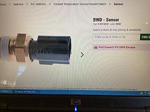

The part number that they sold me is made by bwd and the part number is wt3058.

3.0 6 has a temp sender, 2.3 4 has cylinder head temp.
Ran that number and it shows to not even fit a 05 Escape application..
