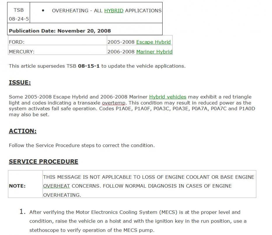

This is the technical service bulletin alerting anyone with the old Bosch pump to a failure. If you have 100,000 miles like mine there is no way you should chance it. The pump is 150 bucks but worth not getting an engine shutdown warning.
