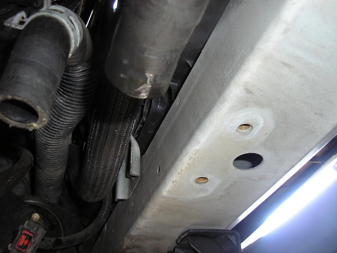

I mentioned in another thread I would post pics of my Motor Electronics Colling Sysytem Pump.
The first is the location. Right by the oil filter. Remove the splash guard to gain access. There are 5 screws holding the splash guard and 2 bolts for the MECS pump. All 10mm.

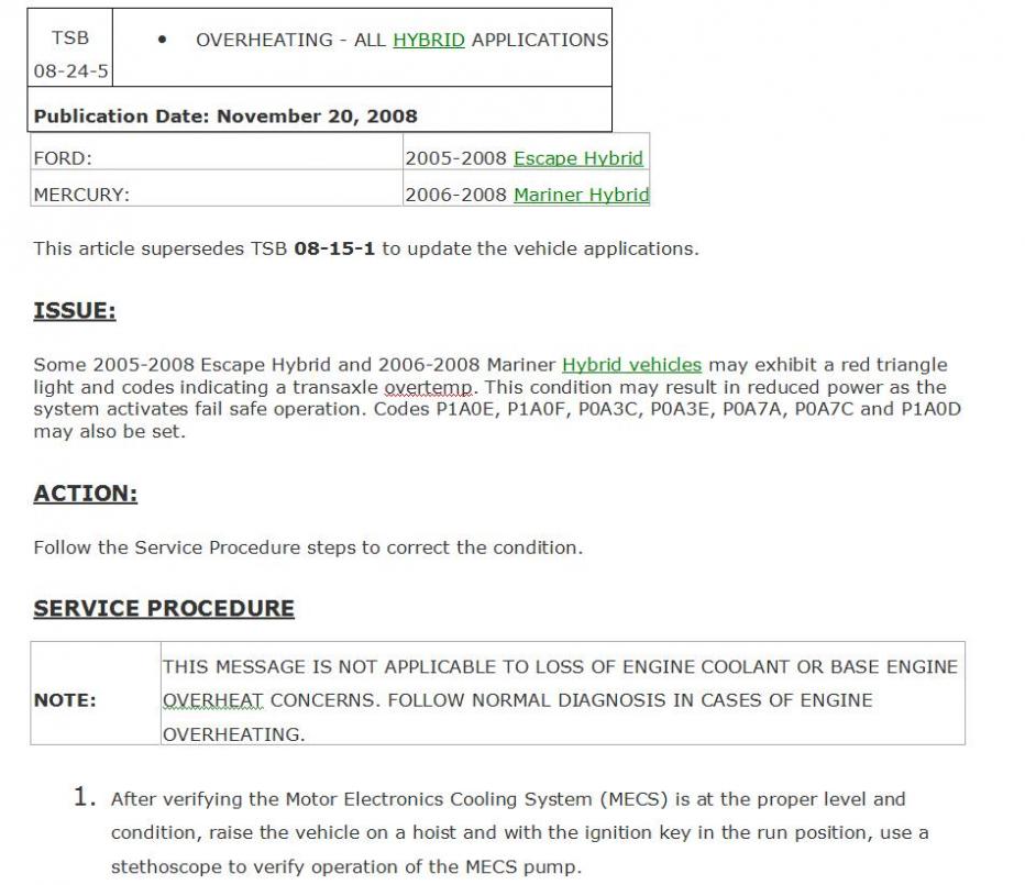

This is the technical service bulletin alerting anyone with the old Bosch pump to a failure. If you have 100,000 miles like mine there is no way you should chance it. The pump is 150 bucks but worth not getting an engine shutdown warning.
