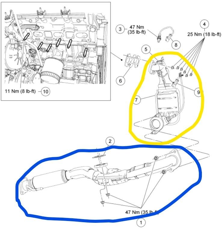

I recently got a 06 and I need to replace all three cats. Does anyone have any pointers about replacing the 2 on the exhaust manifolds? Any pointers, tricks any feedback would be great. I’ve googled it and looked at different manuals but just need more insight.

You did not mention what engine you have, based on you saying there are two on the exhaust manifolds you would have the 3.0 engine.
For the O2 sensors you will need either a 22mm open end wrench which is what I use or a O2 sensor specified wrench.
Get at least two cans of penetrating oil of whatever brand you want and multiple times soak all the exhaust nuts you will need to remove, it will make your life extraordinarily easier.
Since all these bolts/studs are exposed to road grime some will have built up crap in the threads that if bad enough can **** with removing the nuts, hitting them with a wire brush is not a bad idea.
I would replace the gaskets between the cats and the engine heads, you can replace the other gaskets if you want as well but I dont worry about them nearly as much.
I would highly recommend getting a torch to help loosen stubborn rusted exhaust nuts, torch the nut not the bolt, metal expands when it heats up. HOT METAL LOOKS THE SAME AS COLD METAL.
For the exhaust hangers it helps to spray them with the penetrating oil before slipping them off and on, Lisle 38350 is ****ing amazing and well worth the $20 on amazon, I am ashamed it took me two years to buy mine, you can get by using screwdrivers but I really hate fighting exhaust hangers.
If you dont have a set already its not a bad idea to get a set of nut extractors for when the rusted exhaust nuts start to round off in addition to getting a handful of new nuts to replace those you have to use the extractors on, I believe all the exhaust nuts are the same, I have not been impressed with the harbor freight extractors, spend a little more and get better ones.
The studs going into the heads I believe are E torx style and it will be a pain in the *** if any of the studs loosen with the nuts still tight if you dont have the tool for holding the studs, harbor freight is your friend for these.
First two pictures are of the two cats circled in yellow, the Y pipe is circled in blue.
Last picture is the rest of the exhaust system, the exhaust cat is circled in yellow, the muffler is circled in red, the resonator is circled if green.
