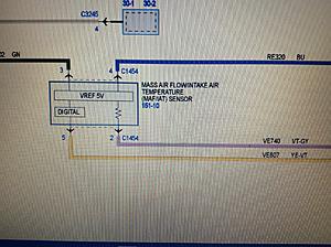

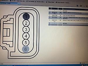

Can someone be so kind as to upload a photo of the mass flow sensor next to the air filter on a 2013 Ford escape, preferably the Escape S? I need to see the colors of the 4 wires of the connector.
Or you can just list the colors from left to right.
It looks similar to this.
Thanks
Old Aug 18, 2017 | 11:45 PM
Hope it helps..
Attached Thumbnails Colors of the Mass Air Flow sensor connector wires-img_1430.jpg   Colors of the Mass Air Flow sensor connector wires-img_1431.jpg

Thanks. Exactly what I need.
