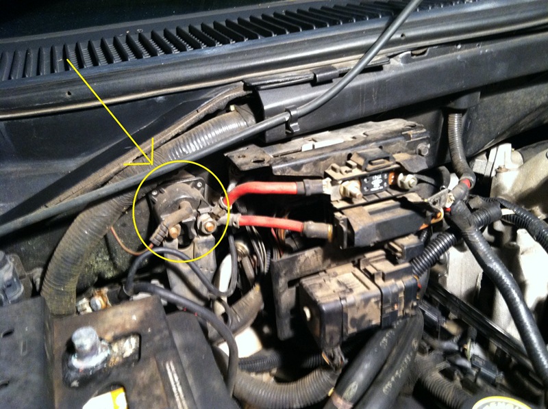

1997 Expedition
Its connected directly to the battery and bolted to the firewall. It has a massive crack in it.
Old Oct 12, 2012 | 02:06 PM
Starter solenoid..
Replace it before completely breaks. any parts house should have one.. Leave the battery disconnected during the change out.
