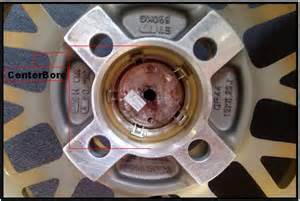

The 114.3mm for the Explorer rear is correct. 114.3mm is 4.5", so the lug spacing should be correct. I would double check the hub center bore measurement. You'll probably find that the Lexus IS300 center bore is 60.1mm and the Ford is 70.3mm. The Lexus rims would need to be bored out to fit. But then, there may not be enough mating surface left to fit safely on the hub.
Attached Thumbnails bolt pattern mishap, now what-hub-center-bore-01.jpg   bolt pattern mishap, now what-hub-center-bore-02.jpg
