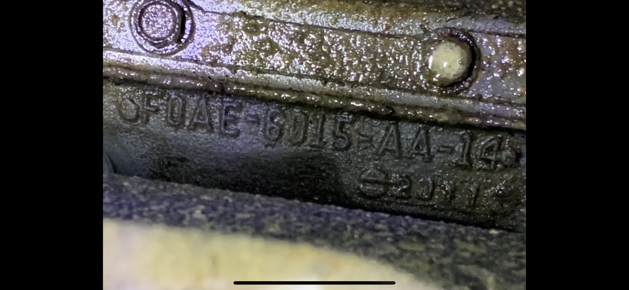

This is my first time on here and I’m looking for help decoding my 351 engine in my 1993 F150 XLT. I looked as much up on google as I could but most didn’t help. My engine number is F0AE-6015-AA-14, I believe I understand the first two mean when it was made and if I’m correct it 1990, but the rest I don understand so any help is appreciated and thank you in advance.

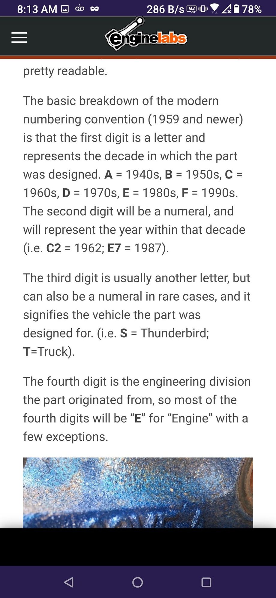

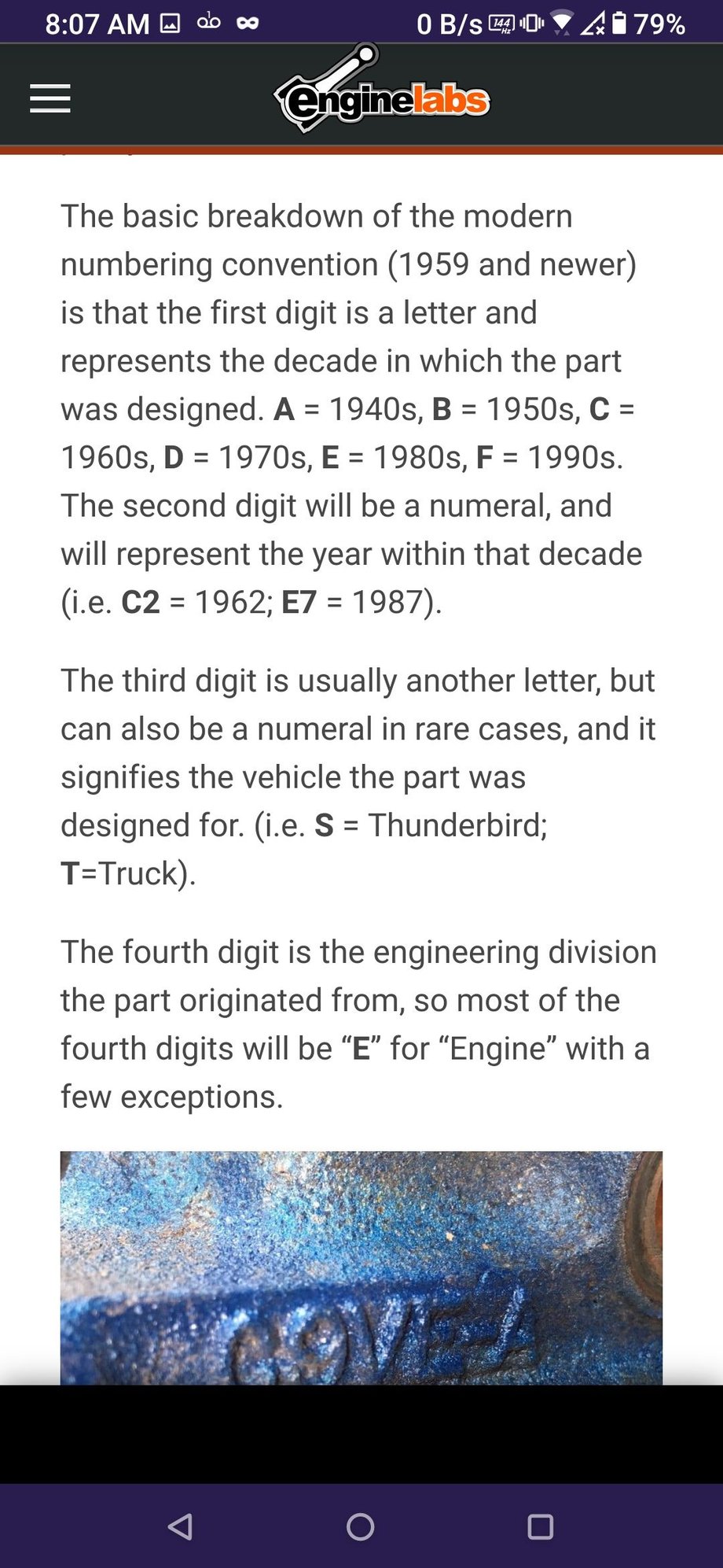

The following will give you the proper information and I will post the link from where I gathered the information.
F4TE means '93-'94 truck engine., (F= decade, 4= year within the decade, TE= Truck Engine.
6015 = Part code for an engineer block.
F4TE----AA = '94-'96 351 Windsor small block, 2-bolt mains. Didn't see the info for the (14).
https://www.enginelabs.com/engine-te...ers-1952-1996/.
F0 = 1990
Gil
