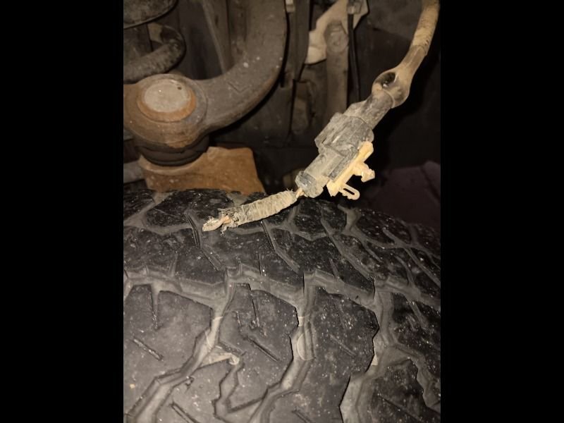

2007 Ford F-150 XLT ABS Sensor and Damaged Pigtail
Anyone happen to know the part number for the ABS Sensor and the damaged severed wire? I had a driver side blow out that kicked off the brake and ABS lights. Looking deeper.. see image.

Just check rockauto.com plenty to choose from over there. Don't pick wrong one if you have 4WD instead of RWD, they are different.

Thank you for the response; I have a 4wd, do you happen to know the part numbers?

1) Motorcraft BRAB192 at $64.79
2) SKP SK970051 at $15.60
Go to that index page and pick more if needed here
The SKP above is already a good choice for you, don't need motocraft everything, ABS sensor rarely go bad, you only need to do a bit cleaning maybe every 3 years. If something goes bad it's the ABS tone ring all the time, so you should be fine with the SKP.
When you buy the front you don't need the sensor and harness separately, they are one whole piece. When you buy the rear then the sensor is sold separately.
Use this "294404459260570971" 5% coupon at checkout, even better saving for you.
Use 8Nm torque spec to tighten the sensor bolt.
