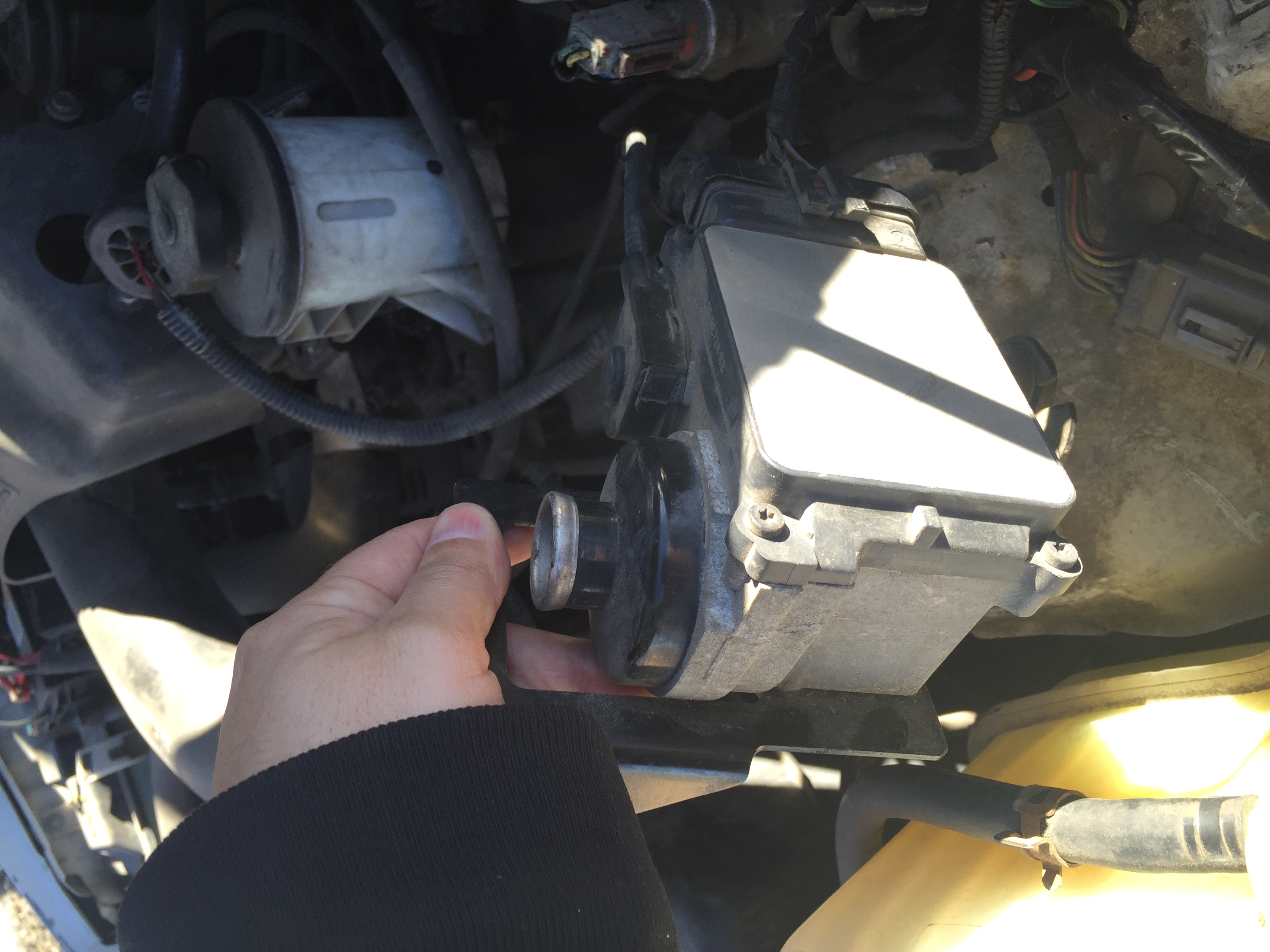

Here is the pic, I found out it's for the cruise control has a throttle cable running to it.

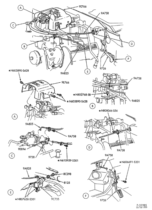

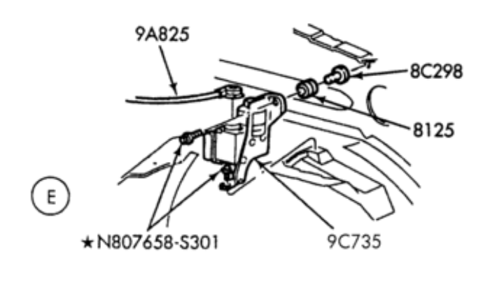

It looks like that is supposed to mount to the firewall. Take a look at the diagrams I have attached. They may give you an idea of where this should mount.
Attached Thumbnails Just got a free truck need help-cable.png   Just got a free truck need help-cable-close.png
