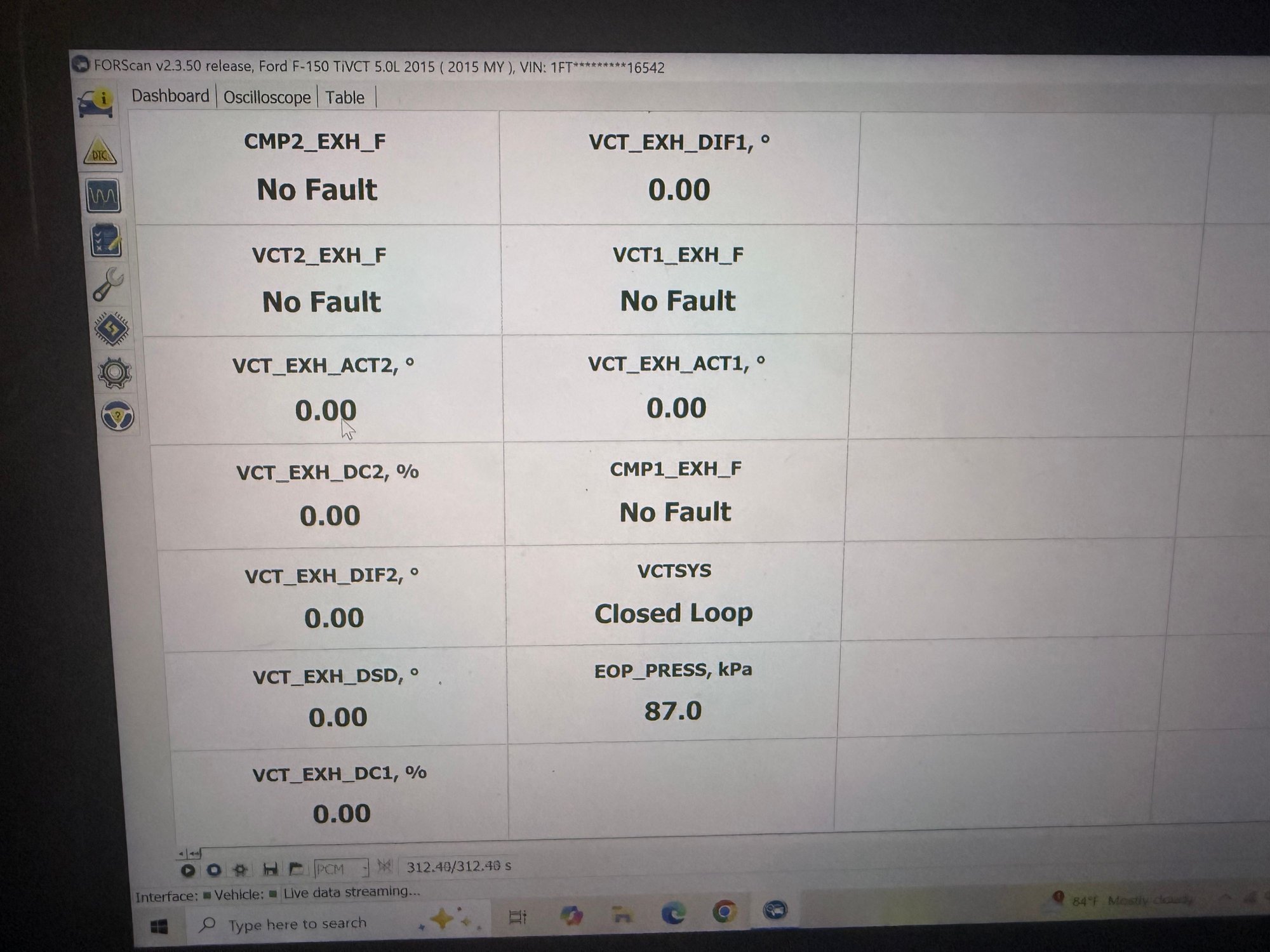

I have 2015 ford f150 5.0 about 140k
all the sudden I had code P0390 and P0394
I replaced the sensor and I even replaced the plug because I thought maybe its wearing off and not getting enough good signals.
still getting check engine code. shows permanent. I clear it it come back
truck idles weird, seems like it lose some power.
I have forscan, and it shows everything is normal. can anyone help me please figure out what's going on so I can get the truck running. I am moving to another state in less than 3 weeks and I am trying to get this resolved before driving for 6+ hours I attached a pic of the for scan
thanks a lot
