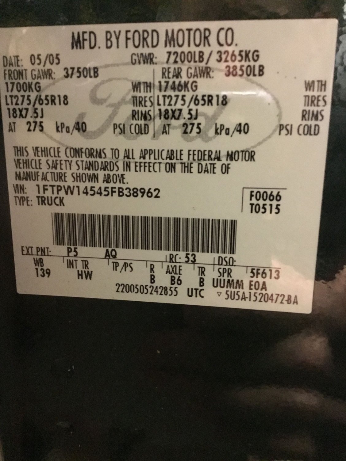

Good morning hanky,
The transmission code on the door is a B. This indicates it is a 4r75e. I should have checked. I think the only difference is the addition of another speed sensor and different ring gear on the E. The readings should be the same. If I am wrong please let me know. Good call on checking the code.
I don’t have the published readings, but I checked the ones on my plug multiple times. I don’t think the plug wires are in the wrong spots. I drove the truck about 100 miles home when I bought it, and it never blew the 14 fuse. If the fuse would have blown it would have set the abs and brake light and I would have noticed it. The forward clutch, frictions and steels were the only ones burnt. The others looked really good. I checked the drum really well for cracks etc.. I know it lost OD because of the eclip that broke on the servo, and I figure the broken piece got into the valve body causing the burnt frictions. If it was something electronic that caused the burnt clutch, and is now shorted, it should not blow 14 when All the plugs are removed from the trans.
