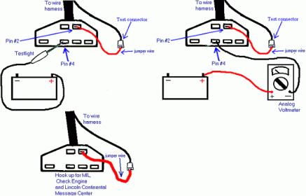

How do i do it? I have a '94 F-150, 5.8L. I know that i need a jumper, but don't remember where to plug in wire.

Here's the lamp flash, meter, test light...
