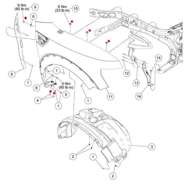

I have a 2013 Ford Raptor. After a recent Evel Knievel stunt my front driver's fender is out of alignment. My door now rubs on the fender. Does anyone have a schematic of the attachment bolts? Not sure what bolts to loosen in order to realign the fender. A detailed description may also work.

Here's an exploded view of the Raptor fender basic attaching points marked in Red.
If you have a nylon wedge or two, it helps to shift and hold the fender forward and keep your hands free, less chance to damage the paint.

Your beat me to it Hayapower! Hopefully between the video and diagram it helps you out. I also hope that something wasn't bent.
