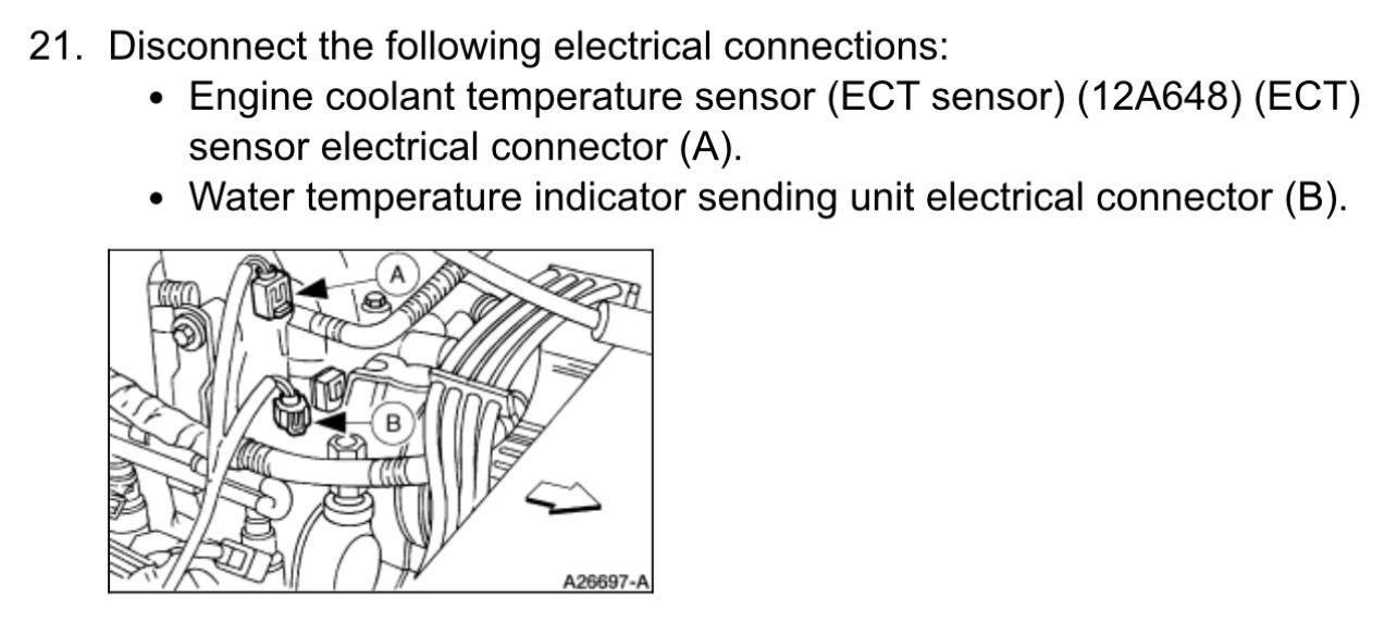

Please tell me what this component is it's at the end of the wiring harness that plugs into all the fuel injectors and it snapped when I was trying to pull it off but I don't know what it is to replace it
This is for 97 f150 4.6 l the W
I believe it's some kind of sensor I would assume it's right behind the alternator I'm just not sure what it is

It's the ECT
