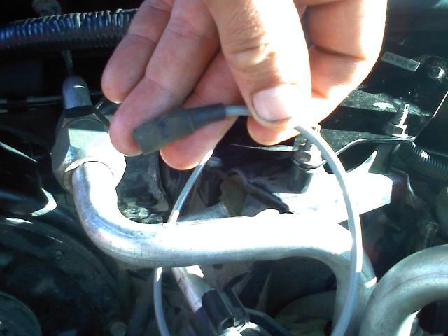

You have a vacuum leak.
First thing to check is the small diameter (hard plastic) gray vacuum line to the heater hose valve. See if it has been disconnected.

Edited the previous post to include a pic.
If it isn't this, post back up and we can go through the other possibilities (vacuum pump issue, leak at a 4WD hub, leaking solenoid valve, etc).
