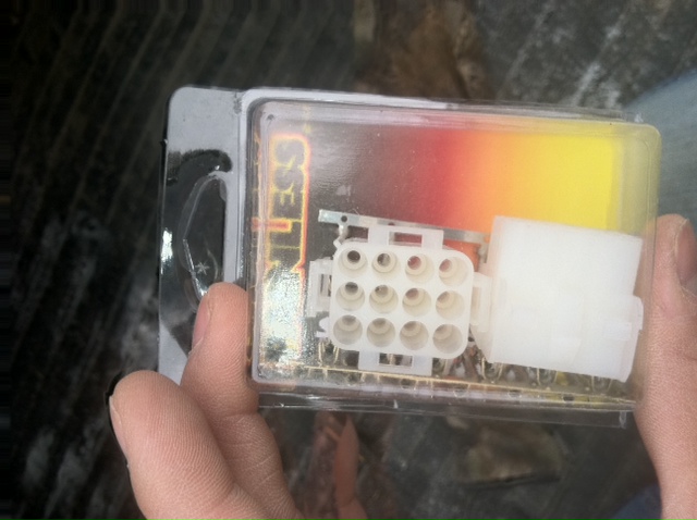

Ok I found that I have 12v at ignition switch. I had a hard time getting to the neutral safety switch wires to test them correctly. When I followed the wires up to the engine compartment I came to a wire harness that is square. This harness also has the wires that connect to the rear lights. Upon examination The wires all broke loose and are now unattached. So I'm guessing that I never had power to the neutral safety switch in the first place. I did prior to the wires breaking have rear lights that worked. So I tried looking for a replacement but now I don't know what part number or the proper name of the harness. Any thoughts? I did get a read at the neutral safety switch in the end and it did not produce any power. Does anybody know of a good diagram or book that explains or names out wire harnesses? My Chilton book just does not seem to do the job right. I don't mind going to the salvage yard to get this but would prefer to get a new one. I don't want to solder one of these in again.

I figured I would add the picture of the harness so everbody would know what I'm talking about.

Ok everyone, I got the truck running and I wanted to offer up the process on how I did it. I first fixed the wire harness that ran the rear lights, neutral safetyswitch and fuel pump and various other things. The truck was turning over but that was it. So I questioned if I was getting any fuel. This truck has been sitting for over a year according to the previous owner. Anyways I took off the pressure cap on the rail and put the ignition key in the run position . This is located on top of the engine, DS above the plug wires. I did not have any pressure. So I assumed my fuel pump was not working. I did not hear the pump working either. After I tested the volts I realized I was only getting 6.5 volts. (Fuel pump is located under the DS door on the frame) Thanks to this website I was able to determine that it was the EEC that was not working. (located under thehood DS right next to the air filter) So I replaced that and walla!!! The truckis running now. I now have to fix a seized up rear brake, give it a tune up and once the old fuel is out change out the fuel filter. Thanks to sites like this I was able to figure it out. Now my $500.00 buy is not looking so bad.
