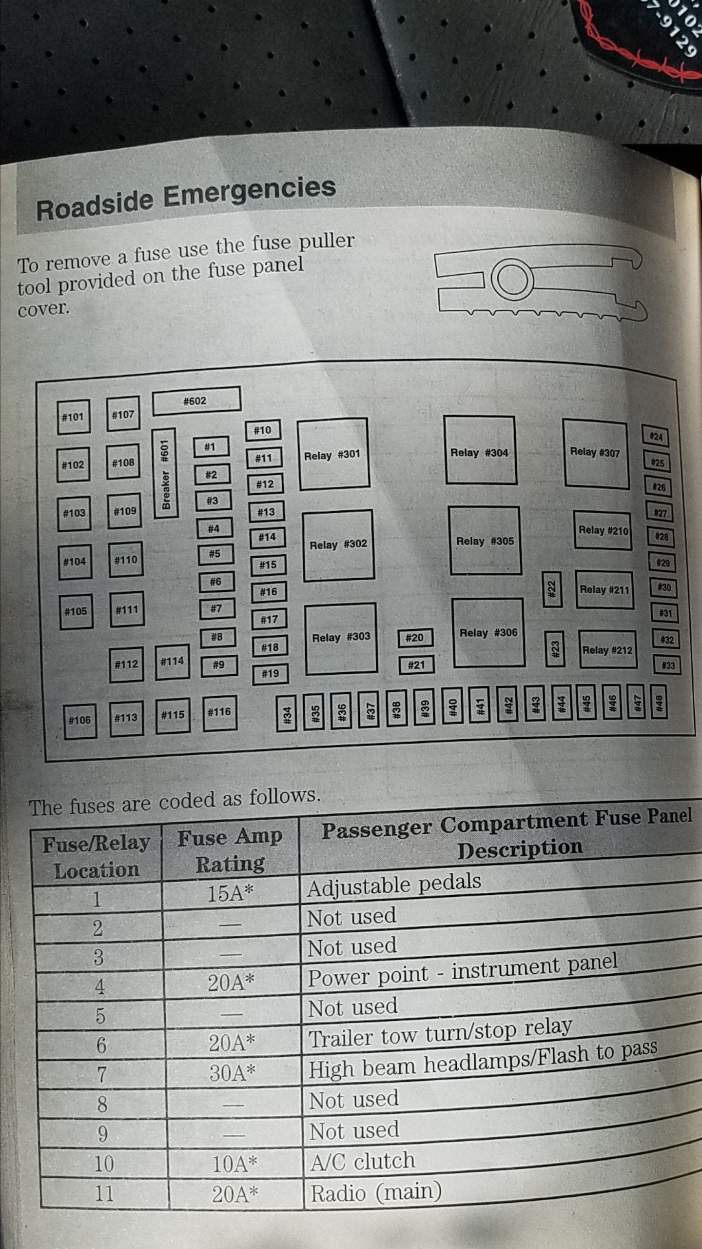

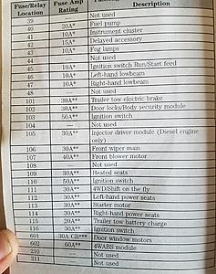

What's the voltage reading on that fuse? Trying to determine if there's a voltage drop in the panel..
Looks good has fooled a lot of folks.
do I pop clear top off and put + side of volt meter on it, other grounded
so I just rechecked #22 engine control fuse and it popped it again?? Weird any ideas.

Looks like your panel resembles an 03.. Late build date 02?
So ,, same circuits only the fuse number changed from #64 to #116..
Just remove the fuse and use your meter to read voltage on the hot leg..
Is your switch/glow relay still connected?
Might disconnect it and see if 22 pops again..
