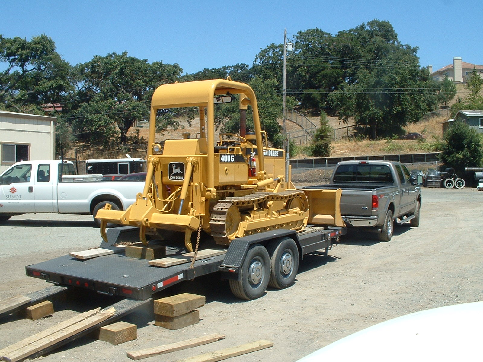

My 250 pulling my dozer across Northern CA.
