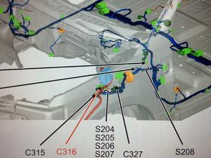

Newbie here. I have just purchased a 2018 F250 crew cab. I will be installing a curt brake controller with the curt adapter cable. My question is where is the pigtail located under/behind dash ? If anybody has done this install your help would be much appreciated.

Welcome to the site,, didn’t see your post..
There are Customer Access wires for an aftermarket TBC controller.
The stub wires are tapped to the harness near connector C316 in the image.
Wire colors are BN-Park, GY/BN-Rev, YE-L/stop turn, GN-R/stop turn, OG-VPWR Trailer batt charge, BU-Trailer brake ..
Attached Thumbnails 2018 F-250 brake controller install ?-0caf4ed8-9903-48e2-bc50-598c4581b690.jpg
