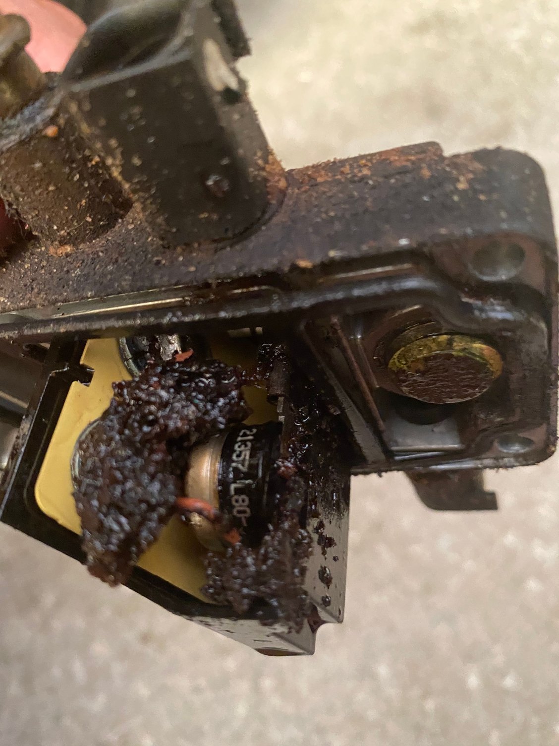

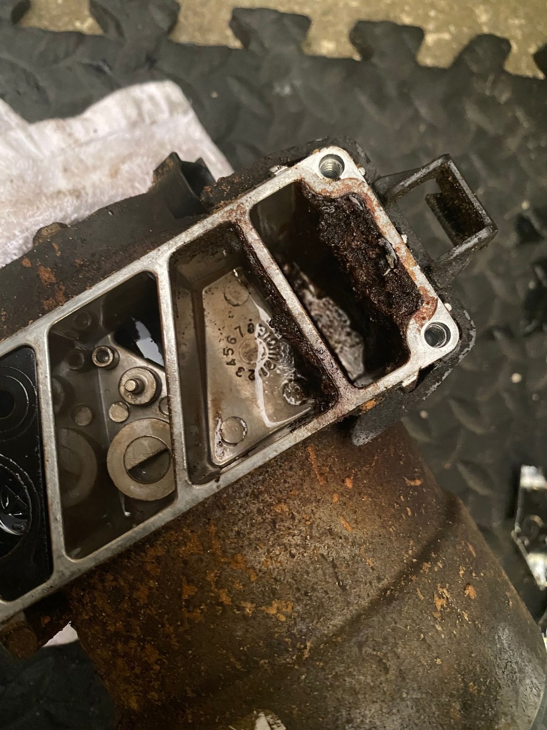

I did remove the HFCM yesterday and there was a lot of gunk in there. Pictures attached. Looks like I need to drop the tank and see what’s going on?

Yeah, I would drop the tank.
You probably should blow air backwards through the pump suction line also.
