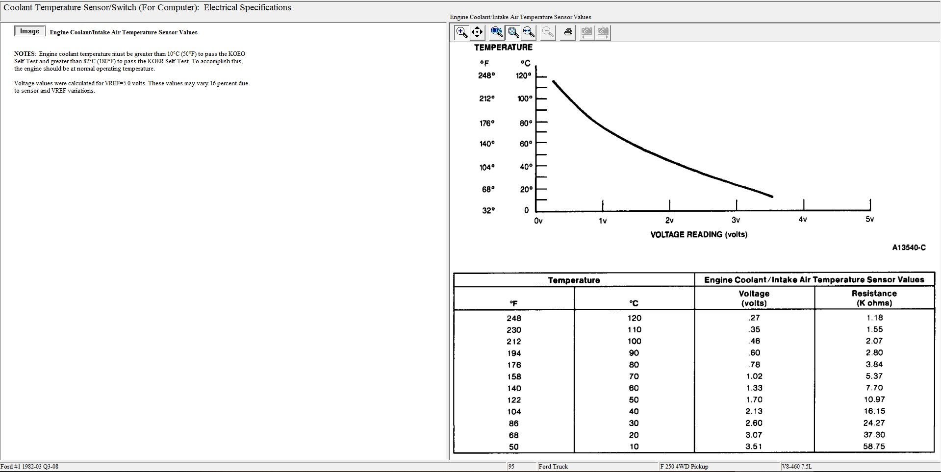

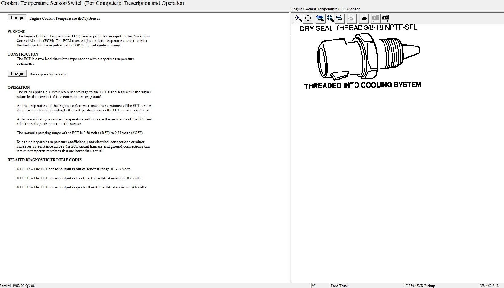

For the ECT don't remove the sensor, just the electrical connector, then go thru the procedures shown below. You should also inspect for corrosion sometime it can cause bad reading, you can use sand paper or wire brush then contact cleaner or electronic cleaner to clean.
If you think you need to replace it, the torque spec to tighten is 10-15 ft/lb
