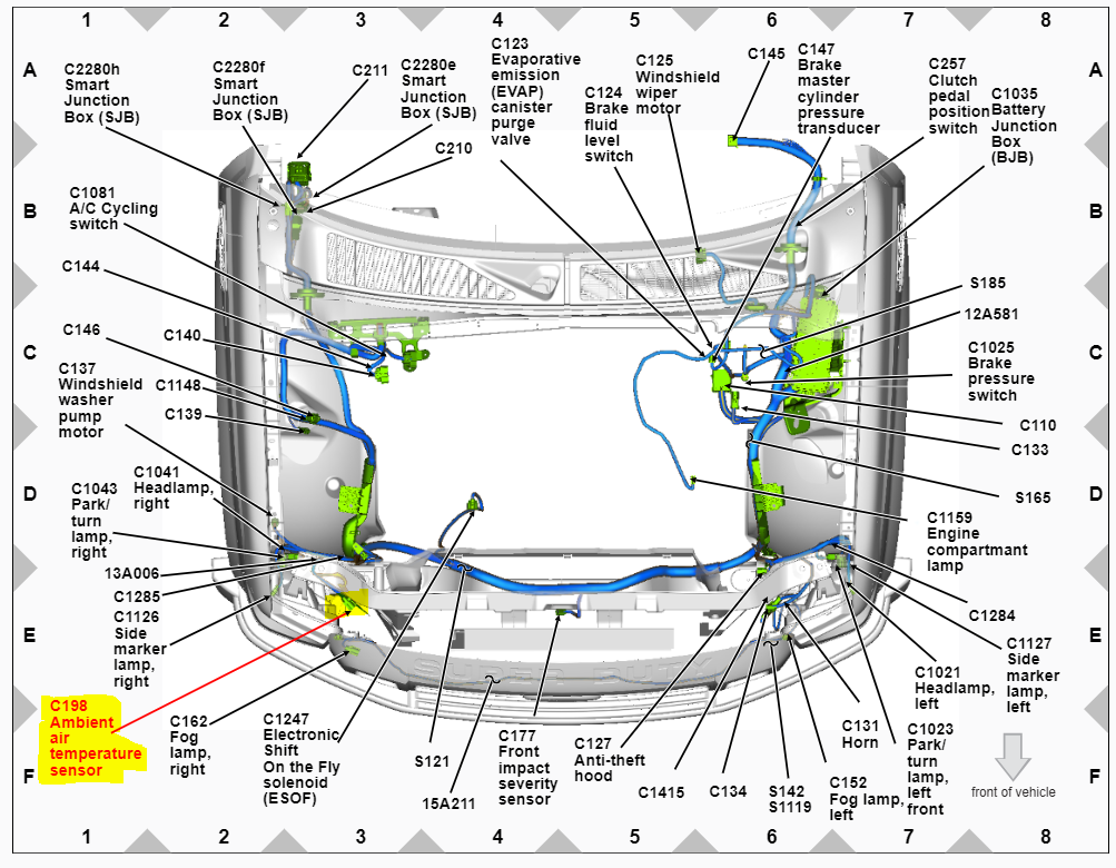

Good evening ,I have an 2009 f350 and I'm trying to. Find the locatio. Of the ambient temp sensor ive check the mirror and at the right side headlight ,any other ideas? Thank you

Since you did not say why you are looking for this you should know this sensor is primarily used for the AC not for the engine.
It is above the headlight.

Thank you ,I have looked all over around the head light ,even pulled the battery and headlight out and still can't find it, reason it the gauge reads 50 degrees all the time and I really just wanted it to work like it should ,
