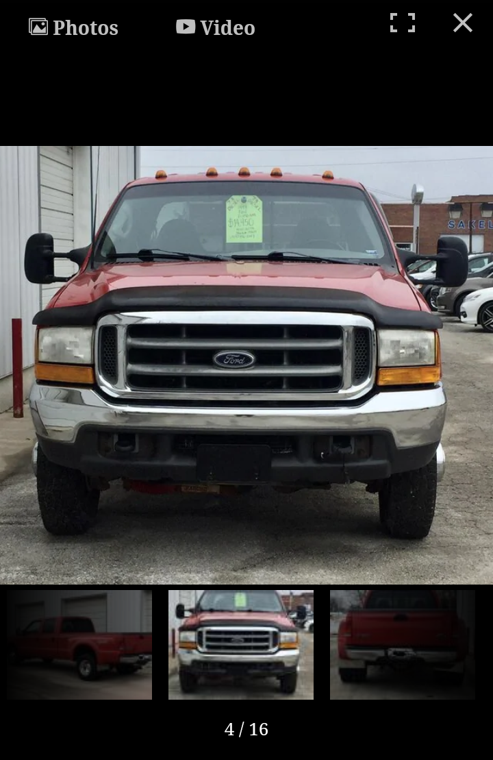

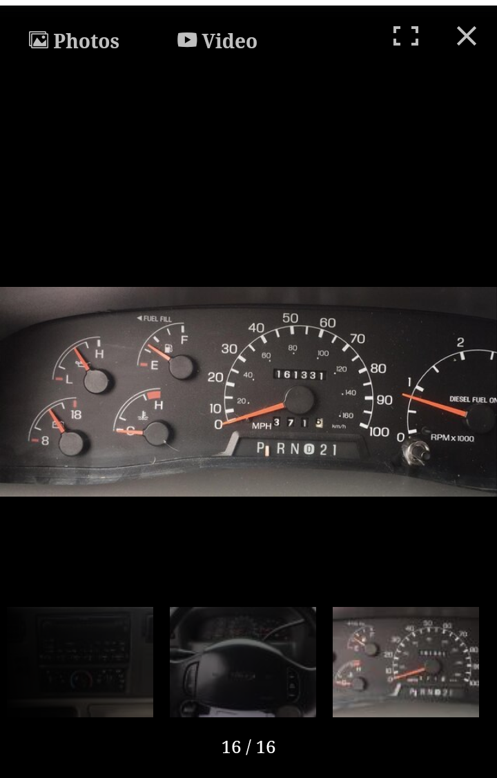

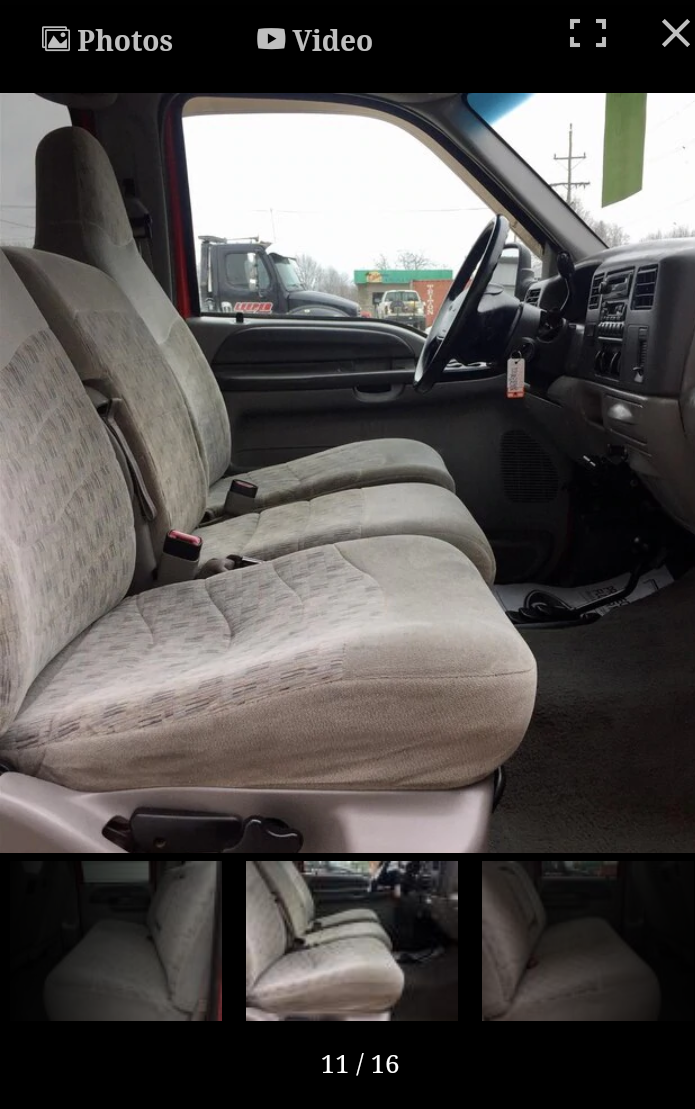

Here are some screenshots from the dealership website.
I wish they'd had some pics of the engine bay. It looks new. I asked if they had powerwashed the engine and they said no.
I'm thinking if they don't sell it from underneath me in the next few days, I'm gonna get it. The other one I'm test driving Wednesday is a couple grand cheaper, but cosmetically doesn't look nearly like this in the pics.
