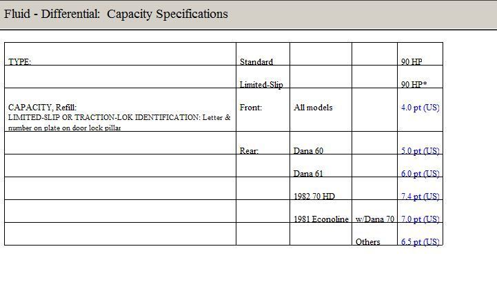

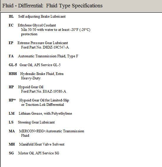

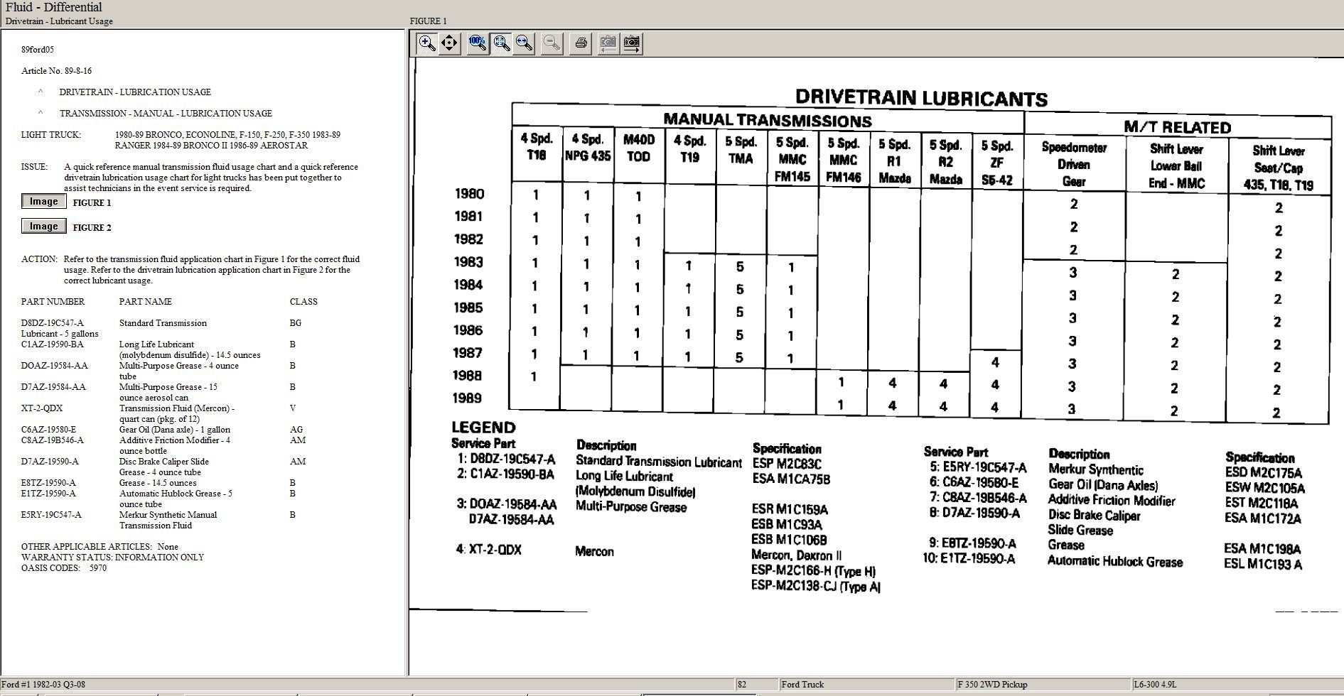

Since you didn't provide the engine size, I randomly picked 4.9L and on my alldata software with cars 1981 or order, emissions only, so the following are for 1982 F-350 2WD 4.9L. And don't forget to check out other PDF files attached below.
You said there might be a leak there I think you should crawl under and inspect without taking anything apart. rockauto.com should carry everything you need.
