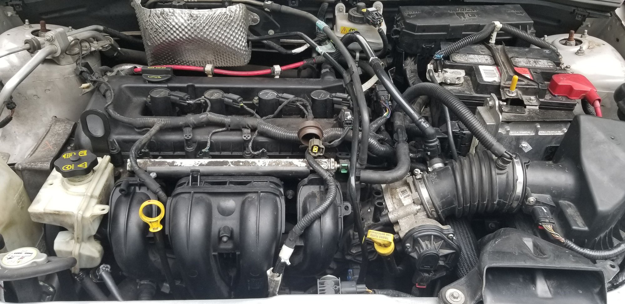

nwachai's Avatar
Joined: May 2021
Posts: 21
Here is the engine. Yes, I am proficient in simple electrical work.

Yes I am proficient in electrical work. Can work with electrical diagrams. I believe this is the original engine - 2.0 4-cylinder

I amused incorrectly, there is only one engine option.
