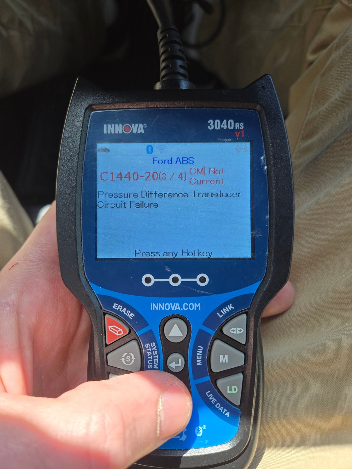

2012 f150 5.0 error codes
Can anyone shed light on what these codes mean?

Locate the ABS module in engine compartment, remove the electrical connector, use 91% isopropyl alcohol and clean. It looks like a wiring issue.
