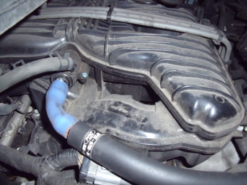

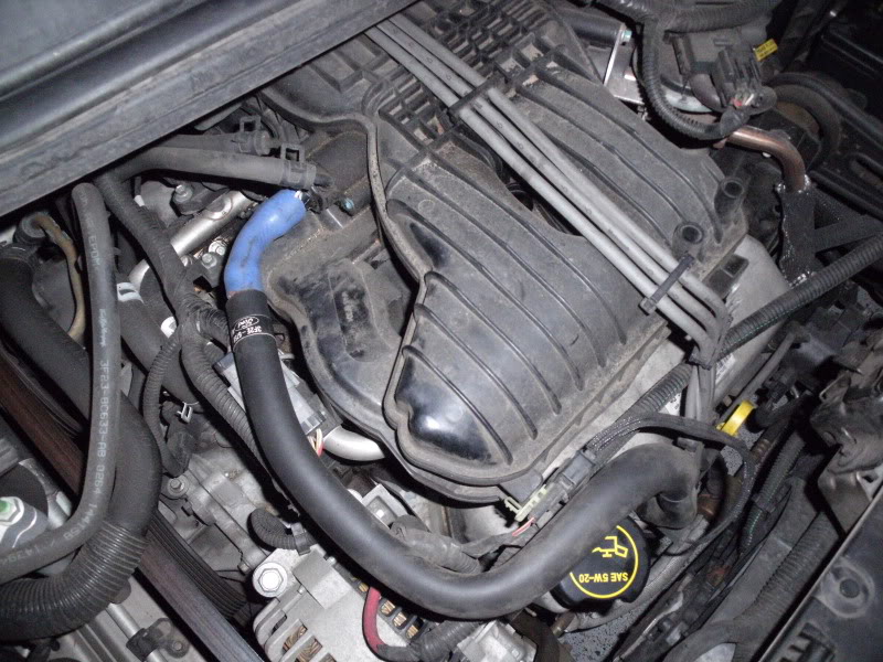

Default Update to my issue...
Vaccum Leak - Causing irratical idle, and engine stall.
Ok here is what I did and what I found out.
  1. Bought a MAF sensor, plugged it in, and no resolution to my engine rough idling and dying. So I returned that.
  2. Bought one upstream O2 sensor, and was about to change it, when I stopped myself to do more research on this issue, since I do not know Fords as well, plus it is an OBDII motor and has way more sensor then I am used too. I discovered that I may have been wasting my time, so I returned the O2 sensor and got my money back, and posted up on here.
  3. I read more and searched more, and posted. I decieded to go back to basics and the cheap fixes first. Bought fuel filter and replaced it.
  4. That did not work. So I remebered what someone in another thread mentioned that he found an elbow on the backside of the intake manifold that was rotted out, and once he replace it, it fixed all his issues.
  5. So I looked all around the intake manifold, and at every hose or pipe I could see, then Bam!!! right in front of me the wholed time, the PVC pipe that goes from the plastice housing on the top of the intake manifold had a pinch in it that I always saw but never paid any attention too.
  6. I replaced that rubber elbow with a radiator hose I had laying around and then started the van back up and waited. Yay!!!! All fixed.
As you can see in the pictures below the culpurit was a vaccum leak on an rubber elbow on the PVC hose. Replaced with the blue radiator hose and walla!!! Idle and stalling issue resolved.

I was already calculating what it would cost me to replace the fuel pump and stressing over the process of dropping my gas tank or buying 4 O2 sensors and replacing them, or removing the intake manifold to replace the gasket no knowing if those will all work.
