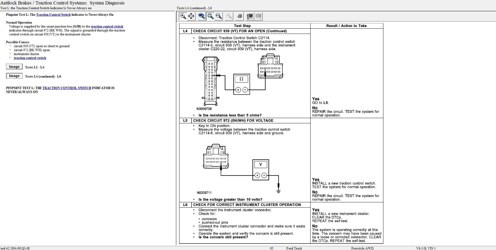

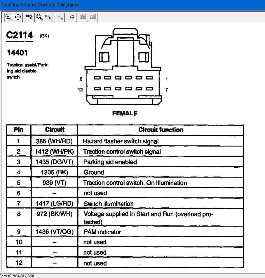

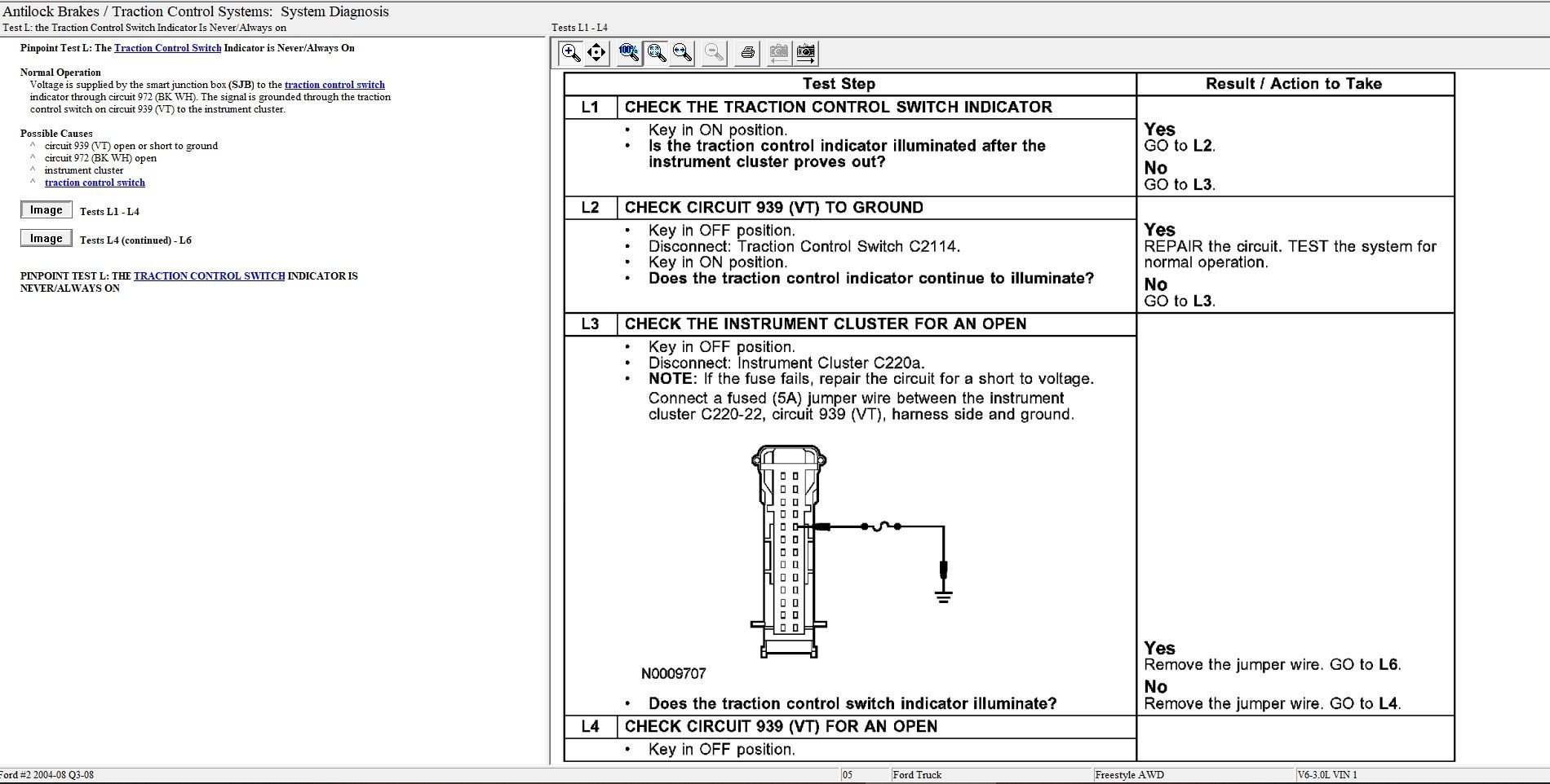

Hi I have an 05 Freestar Limited, however being a limited the van does not have all the bells and whistles that you may think it should have. It doesn't have the adjustable pedals, parking aid sensors, auto dimming rear view mirror, garage door opener, or traction control. It does have ABS though and automatic siding doors and an automatic lift gate. I have no idea why it has some features of a limited but not all. Anyways I live in Colorado and I wanted to see what I can do about installing traction control to the van before the snow season comes. Like do I have to just install the switch? Is the wiring already there? I have all 4 wheel speed sensors so I feel like it shouldn't be too hard.

Before you buy the switch go over the following and see if you have that and if they are prewired.
PJMZ28
Aug 6, 2015 04:22 PM
artcat99zl
Jun 11, 2015 09:07 AM
speekpe
Mar 16, 2015 11:13 PM
Twerdun89
Jan 29, 2012 03:51 PM
rcook
Feb 11, 2008 10:44 PM
