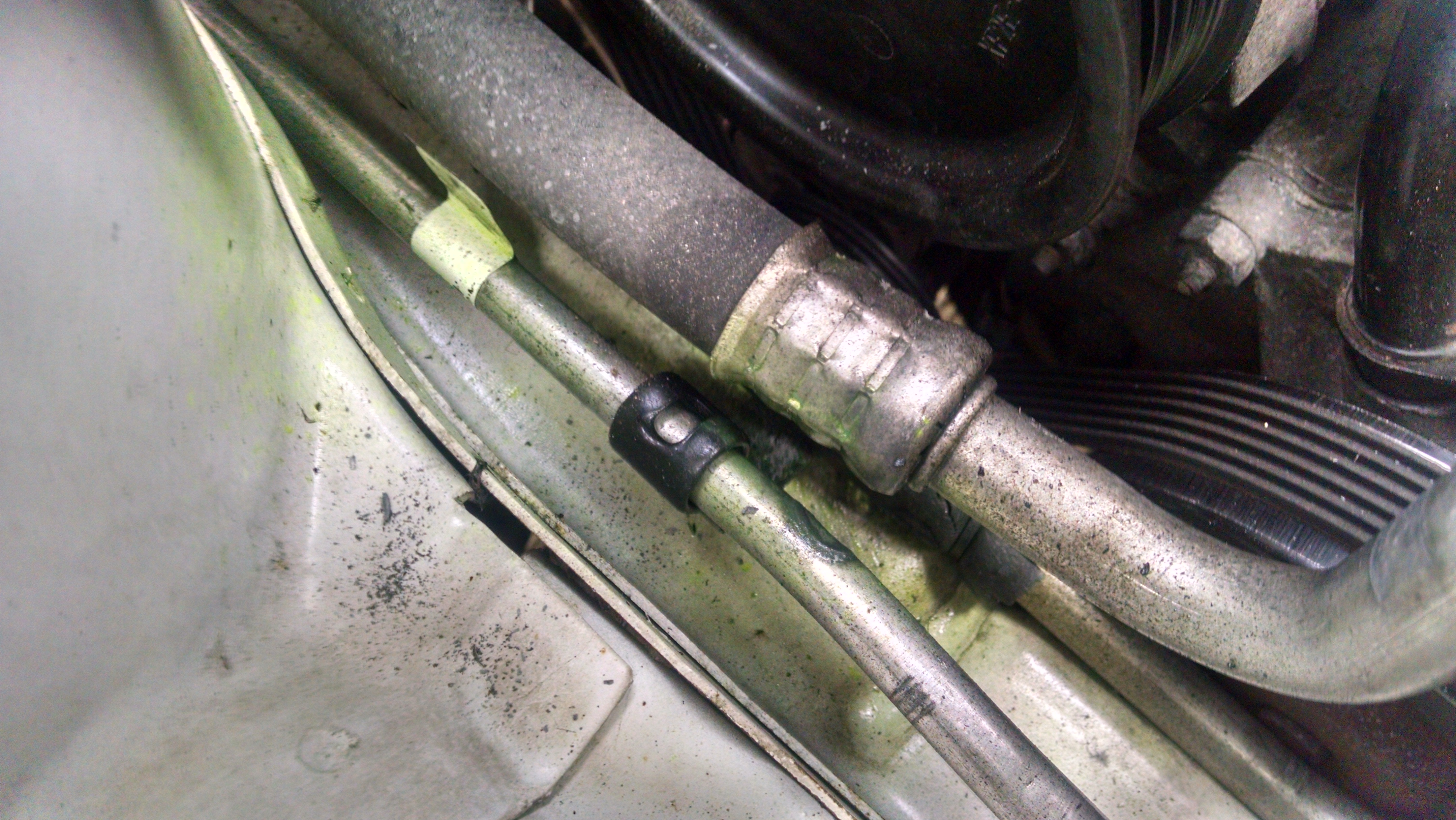

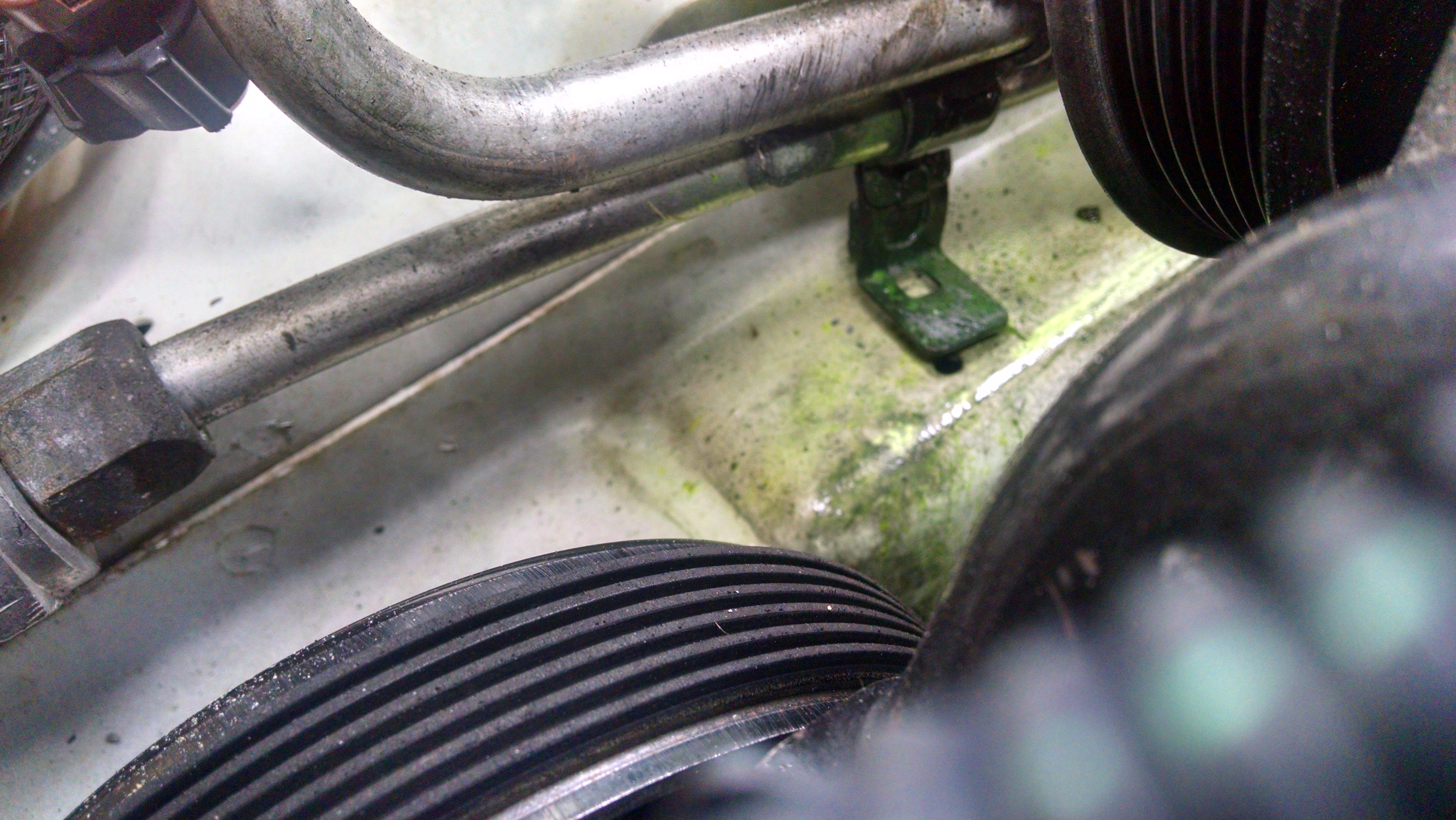

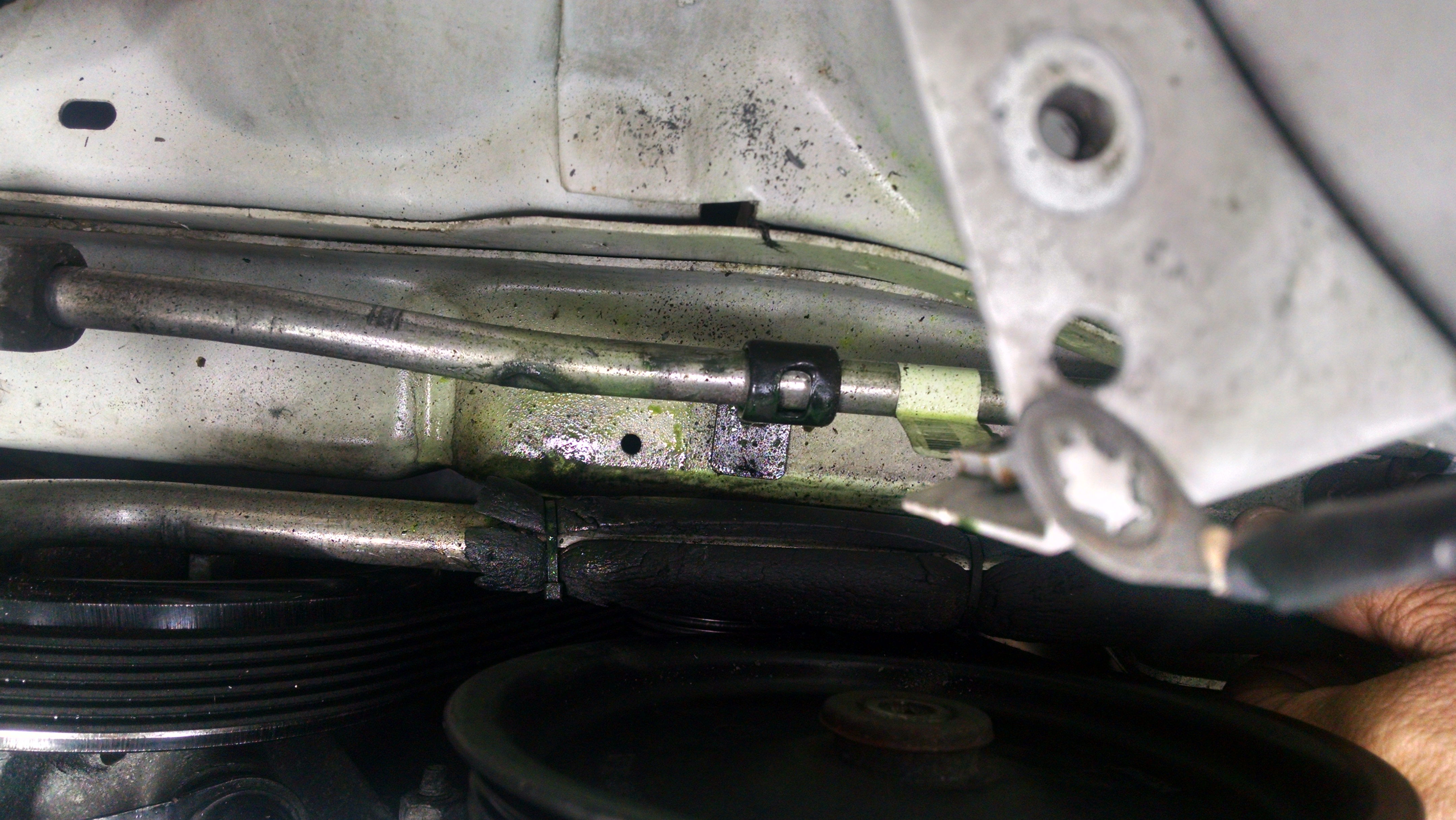

Well, was 92° Saturday here in my neck of the woods in Western NY. Was tooling down the highway with a cool comfy breeze on my face when I noticed it getting warmer and warmer. Then it was just plain HOT. Checked and sure enough, no A/C compressor engagement. Got home and slapped the gauges on the A/C and sure enough, no pressure. System was completely empty. Gotta be a leak somewhere, so I put the nitrogen to it and sure enough, hear the hissing just below the accumulator area. Yep, leak detect everywhere. Tore the system apart and what do I find? A wear hole in the liquid line. Apparently the $29,000 sticker price of the van didn't include the missing $.03 hold down bolt for the bracket. Heck, I would have paid $.15 for the bolt. So, I cut the bad spot out, went to the hardware store and got a 1/2" compression line coupler to reconnect the line. Went ahead and installed a new front orifice (good thing as it had some crud build up on it) and buttoned everything back up. Pulled my 2 hour vacuum and charged the system back up. All is well at this time. Nice and cold...
I would say to all Freestar/Monterey owners to look at this bracket and ensure Ford bolted it down.
