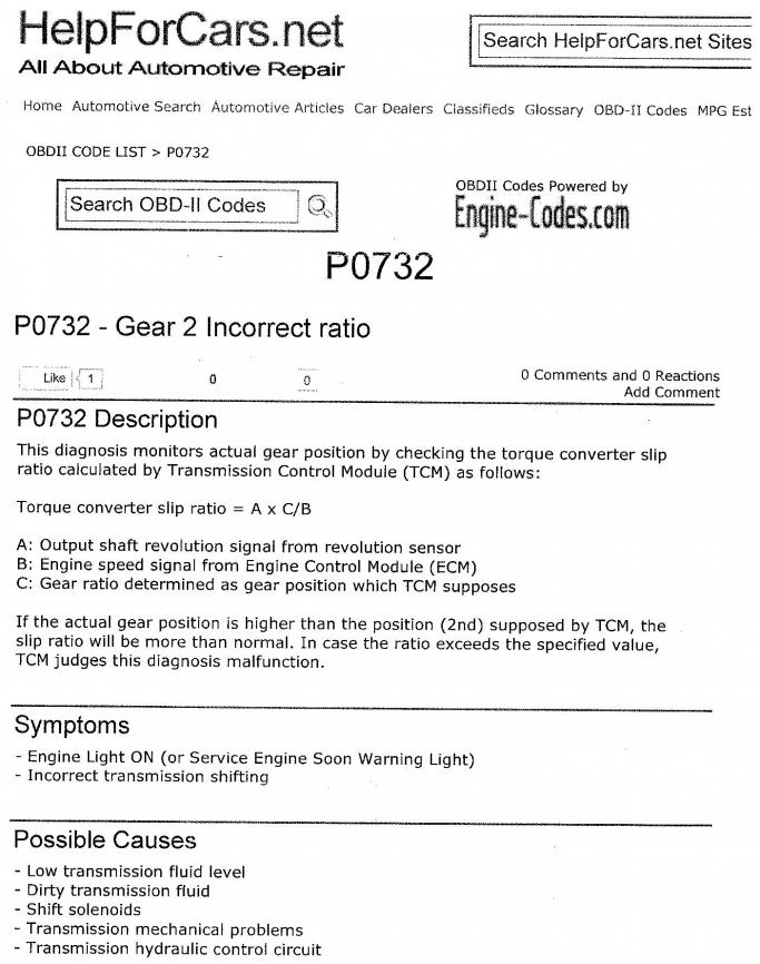

Default trans. issues / codes
I own a 2005 freestar and I attach the codes I got fom my mech code reader, are this codes related to the torque converter recall ???
THANKS
