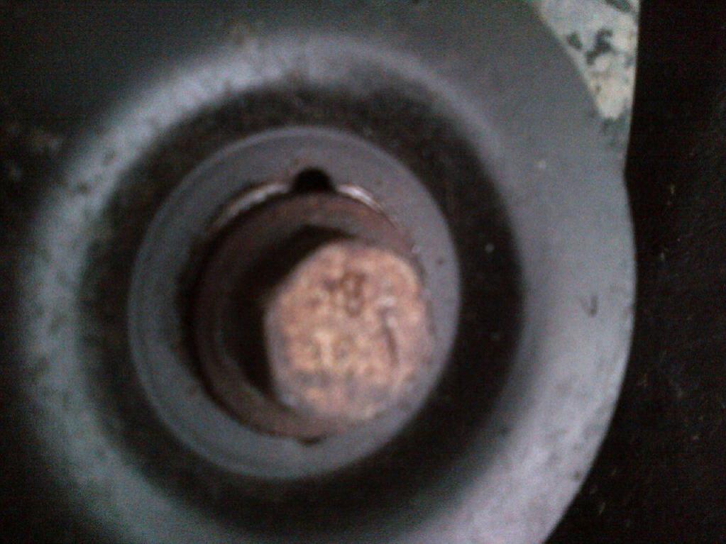

I live out in Yorkshire. Picked the van up last night and it runs the same as it did when I dropped it off. I did notice that the van wants to pull to the left a little since they dropped the under carriage to perform the converter replacement. I let them know and told them that I would give it a few days to settle back in. If it doesn't, they will do an alignment on the van since I don't need the tires to start getting chewed up. Haven't had a chance to look over the work since it's been raining. I asked about my old torque converter. The mechanic said that the old one was perferctly fine. Guess that means that the new one should be bullet proof .

Well, have an appointment for wednesday to get my front-end alighnment as the van still pulls to the left after the torque converter replacement. Was told that they (Ford) use an 'Alignment Tool" to re-install the sub-frame and the alignment should not be out. Well, after driving the van for 8.5 years and almost 128,000 miles, it has never pulled either direction until the recall was performed. I even gave it a few days of driving over various road conditions to see if it would "Settle in", and it still pulls. Will update the results after Wednesday.

It's not the tires. The subframe is actually not bolted into it's original position. The subframe is actually rotated counter clockwise from it's original position causing the vehicle to head left. This is then causing me to keep constant clockwise pressure on the steering wheel to go straight. This in turn is now causing my tires to wear and "Feather" across the tread.

Well, got the front end re-aligned. The van now tracks like it did before the torque converter replacement. Thought they would have re-bolted the sub frame back into its original position, but that wasn't the case. They just did a 4-wheel alignment. Here is a somewhat blurry picture of one of the sub frame bolts new positions. All 4 are off from their original location. With all 4 like this, the sub frame was rotated counter clockwise causing the van to head due left.
So, as a sugestion, I would double check your steering after a converter replacement.
