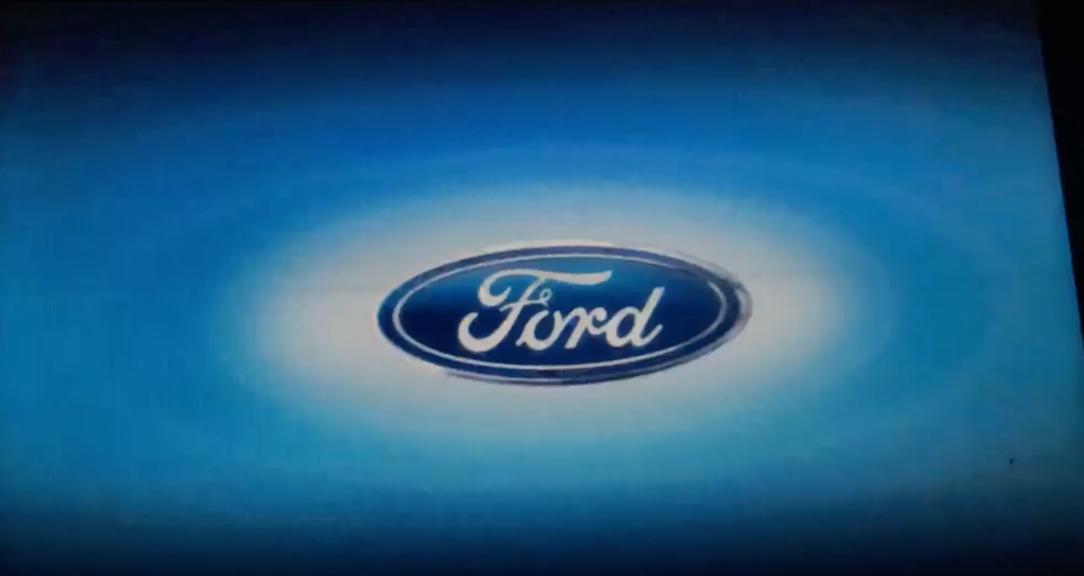

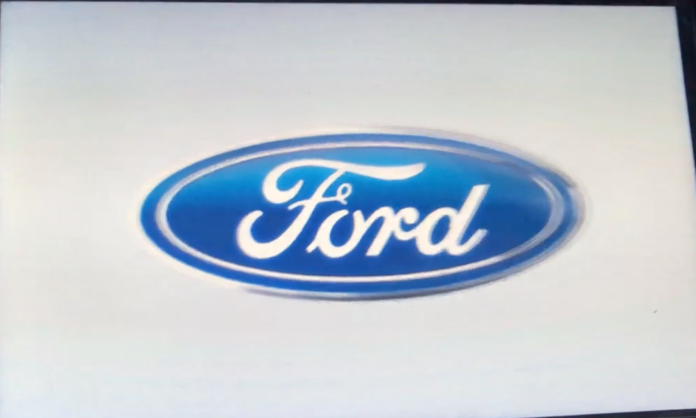

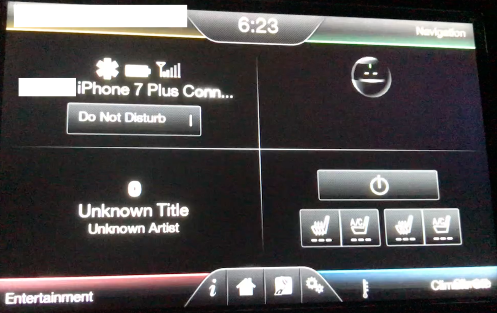

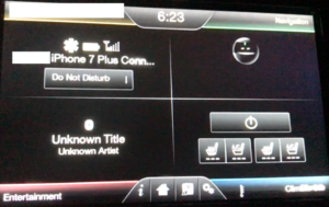

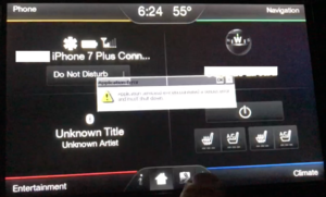

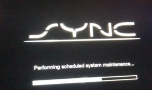

A couple of weeks ago I started my car to see MyFordTouch screen go into system maintenance mode and then crash/reboot continuously. This issue happened with my 2015 Ford Fusion Energi Titanium after just under 3 years of ownership. I've attached 5 picture sequences showing the issue:
  1. Sync Software goes into 'Performing scheduled system maintenance..." mode. I've never seen this before so this was the first sign of trouble.
  2. With a Ford tech on the phone, I was trying to do a "
    ". No luck.
  3. The crash with "Application servicesd.exe encountered a serious error and must shut down." error message.
  4. Ford logo after crash.
  5. Ford logo fade to black. Queue
I have about 41K miles on the car with no factory warranty remaining. Fortunately, I bought the dealerships extended warranty. They are having to order a new Accessory Protocol Interface Module (APIM) and will be installing it for the $100 deductible on my extended warranty.
