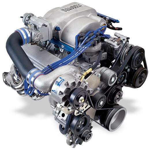

My question about this vortech is that with the Stock engine putting 225hp and the charger saying it will produce 331hp..That makes 106hp GAIN? ANother question is the picture I have attached shows a "saleen" intake..Does this come with the system, or do I get to choose my own??

For the style of super charger pictured, I believe you would supply your own inake, but not 100% on that.
