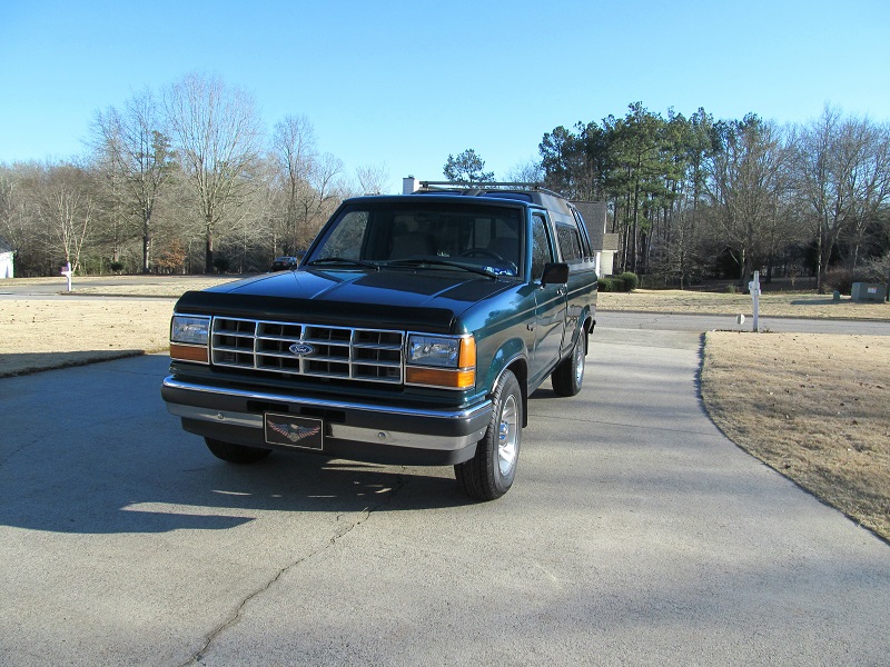

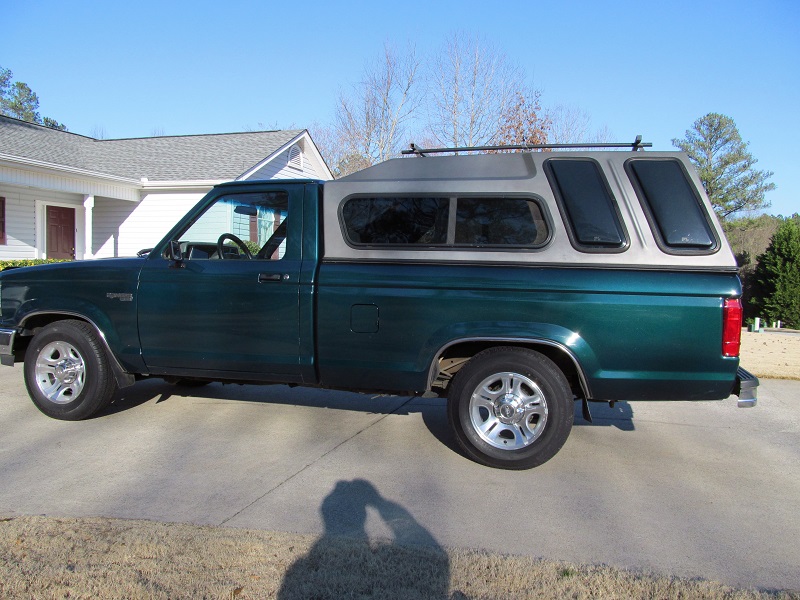

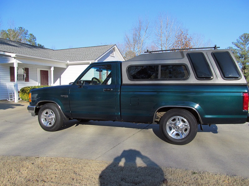

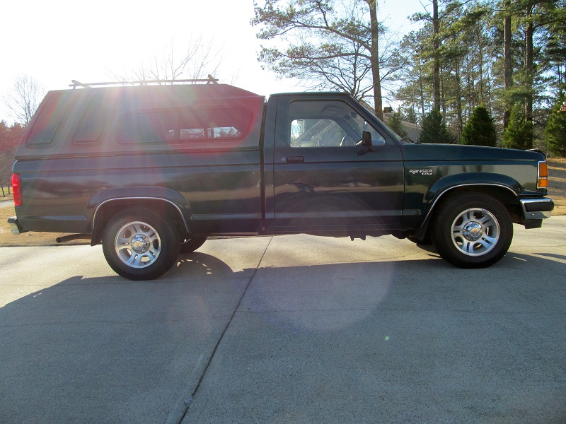

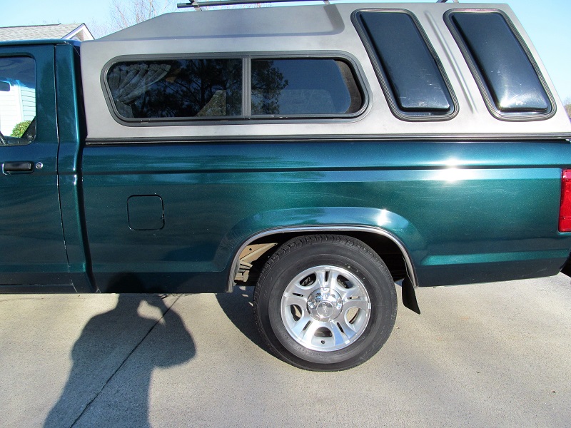

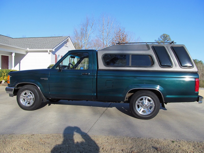

Ok here are the pic of my 91 ranger XLT. 5K mi on the 4.0 Jasper Engine runs great. Life time Guaranteed on Auto tranny. New headliner, new instrument cluster, New Windshield, New Mirrors, new Sony Stereo, new head lights and tail lights. New brakes all around.
Like new 15x7 ranger wheels & new tires. etc etc. over 400K miles on the original engine that still ran great. This truck is in VG condition and the new wheels make it.
I bought it new in 91 and it has never been wrecked...........

That is a sharp ranger! The wheels look good too. Thank you for sharing!

Thanks, been working on the restore since last summer. Not bad for a 25 yr old and 400k mi ranger. The interior looks about new too. Sorry if I sound a bitt proud.
