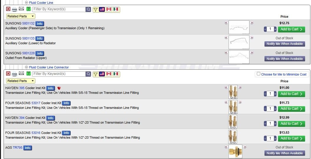

Below is what I found from RockAuto:
Don't forget to download the two PDFs above.
