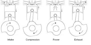

It take two (2) complete revolutions (720 degrees) of the crankshaft for a four stroke engine to cycle through all four strokes.
Here is a diagram:
http://t3.gstatic.com/images?q=tbn:A...tAKTM5joOdDg&t
Suck-Squeeze-Pop-Blow. Each stroke the crank turns 180 degrees. 180*4=720
The timing mark on a harmonic balancer/pully will point to zero on the timing scale at TDC of #1 piston compression stroke, and then again at TDC of the exhaust stroke.
If you just rotate the crank so the timing mark points to zero on the scale it could be either one.
Piston #1 must be at TDC of the compression stroke to install the dist. correctly.
This is why I posted the method of placing a finger over the sparkplug hole, and stop cranking the engine right as compression forces air out the hole.
