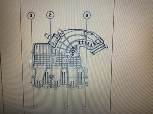

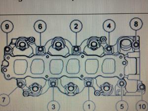

What are the torque specifications and tightening sequence for the intake manifold of a 2011 Ford Taurus SE 3.5L?
-Thanks

All 89 lb-in including T stat cover.
