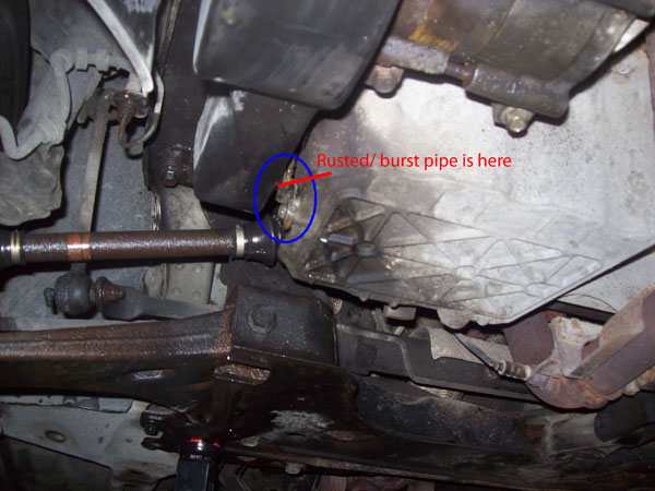

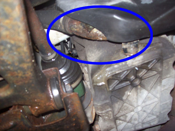

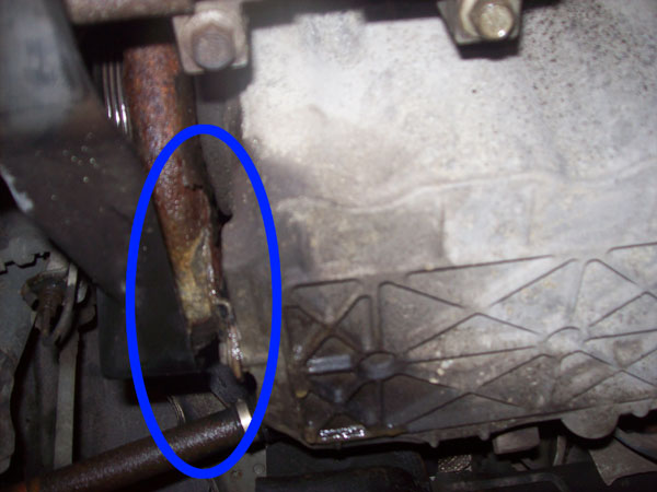

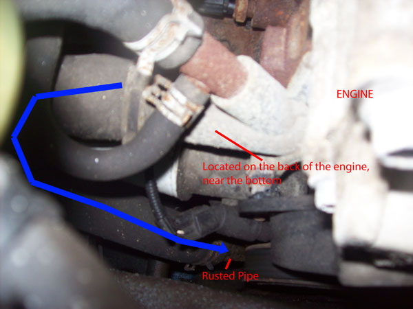

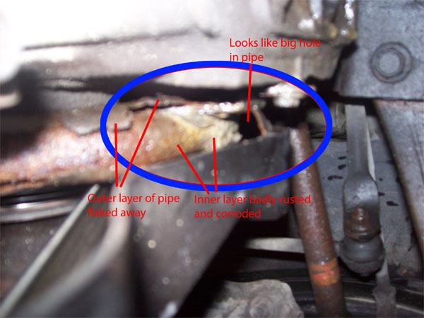

My 2000 Focus SE had given up on me, consistently leaking coolant leading to my car being broken down on the side of a busy road. When I jacked the car, I found and extremely rusted and corroded pipe that seemed to be the cause of the leak (more like a pour). I want to save money by fixing the problem on my own so if anyone could tell me what pipe I need (simply the name or a specific part number for 2000 Ford Focus SE) , it would be greatly appreciated. The attached photos show the damaged pipe and the area in which it is located.
If anyone can provide me with the name of the part or links to threads that show info on replacing, it would be greatly appreciated.

Found it. For anyone else looking, it is a COOLING TUBE and part number is KM-4493. Cost is 140-160 at the dealer. I am considering doing a workaround using only tube so I will update with a tutorial for other in the event that I do.
