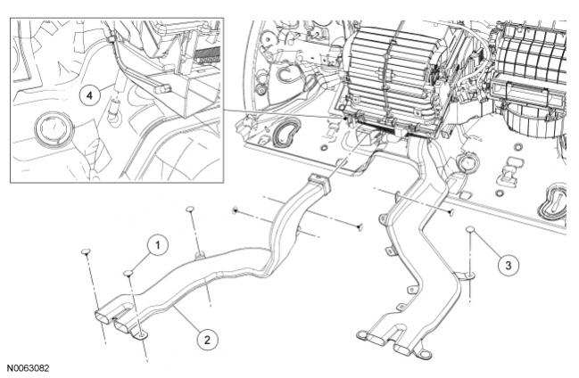

Had my edge in the dealership as there is water sloshing around in the dash and leaking onto the floor of the passangers side. I beleive I have a drain line clogged. Any suggestions on fixing?

There is a drain tube in the engine compartment under the A/C housing. It may be just a small circular opening, or it may have a little rubber elbow on it. Look at number 4 in the picture below. It seems to be toward the center of the vehicle. This is a diagram from inside the vehicle.
