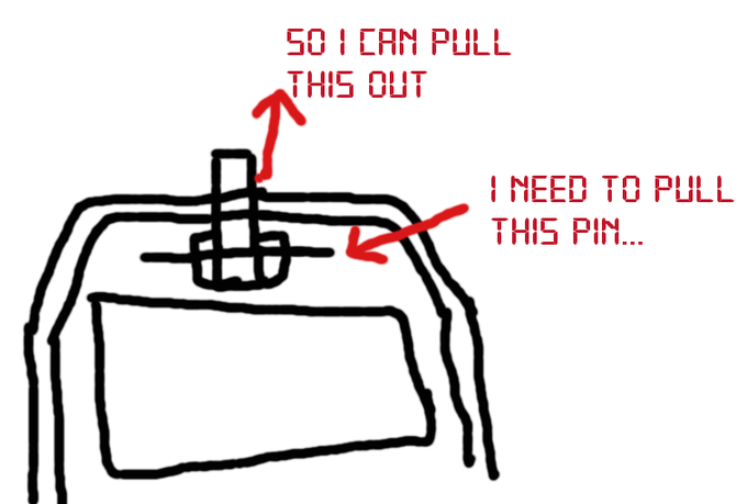

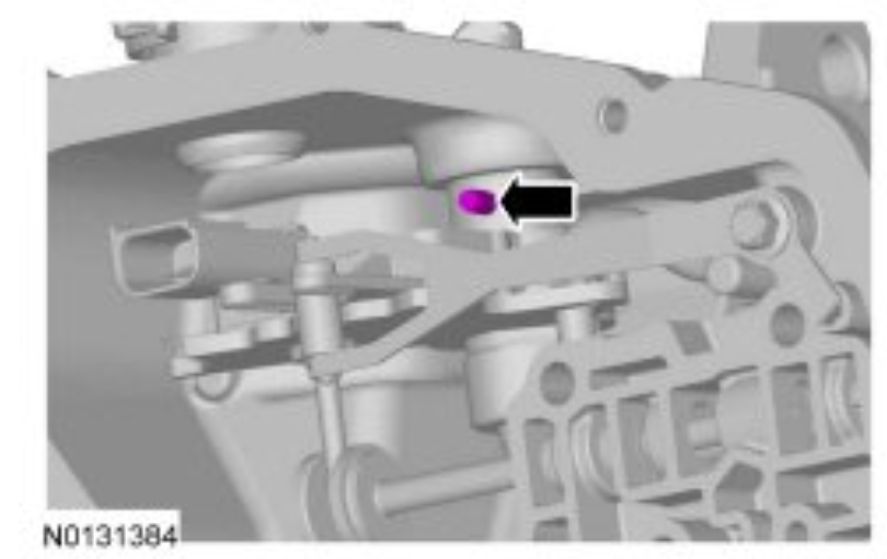

So I decided to take on this job, since the mechanic didn't want to do it, and I think i know why now.
I have been trying to pull this pin for 2 days now, with no luck. The guide says put locking plyers on it, and remove the pin.
I tried that..
I also tried to hold onto the handles of the vice grips with a large pair of channel locks and tap/bang on the channel locks to get it to budge.
I tried heating the shifter bolt from the top and do the banging on channel locks.
Anyone have any other ideas on how to remove this pin?

On the typical E/F series I'd use jaw locking pliers instead of channel lock pliers especially on a tight spot. Sorry can't help you on removing the TRS, hopefully someone else can assist you or you just have to search youtube on that.
