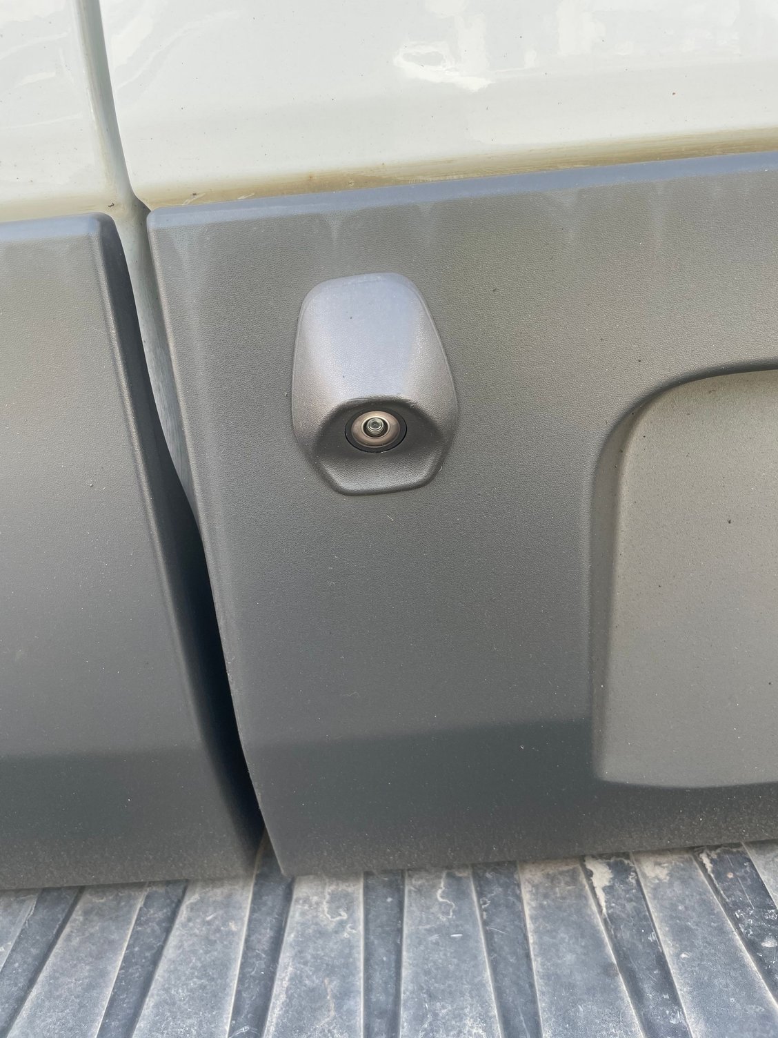

Post pictures of the backup camera the vehicle has and specify what happens when you put it the vehicle in reverse.

It’s still in the shop for other repairs so I can’t take a picture of it at the moment. The way it worked when I test drove it was the screen in the middle of the dash would change to the camera view once the vehicle was put in reverse. Now when I backup it makes the reverse beeping noise as well as the reverse lights activating but nothing happens or changes on the screen in the middle of the dash like it did when I test drove it. Here’s the vin: 1FTYE2YG1GKA96754. I’ll provide a picture of the backup camera once I get it back from the shop in a day or 2.

Was the camera built i to the vehicle ir an aftermarket one like those that attach to the license plate?
Ford reverse cameras though provide a very clear picture compaired to other manufacturers do not have a great reputation for lasting long.
If its a factory ford system what usually happens when the camera dies is the screen changes when put in reverse cause it knows there should be a camera input, depending on the fault sometimes the screen is just black sometimes it will say "see dealer for service" or something along those lines.

Here’s the picture of the camera. I finally got the vehicle back from the shop.
